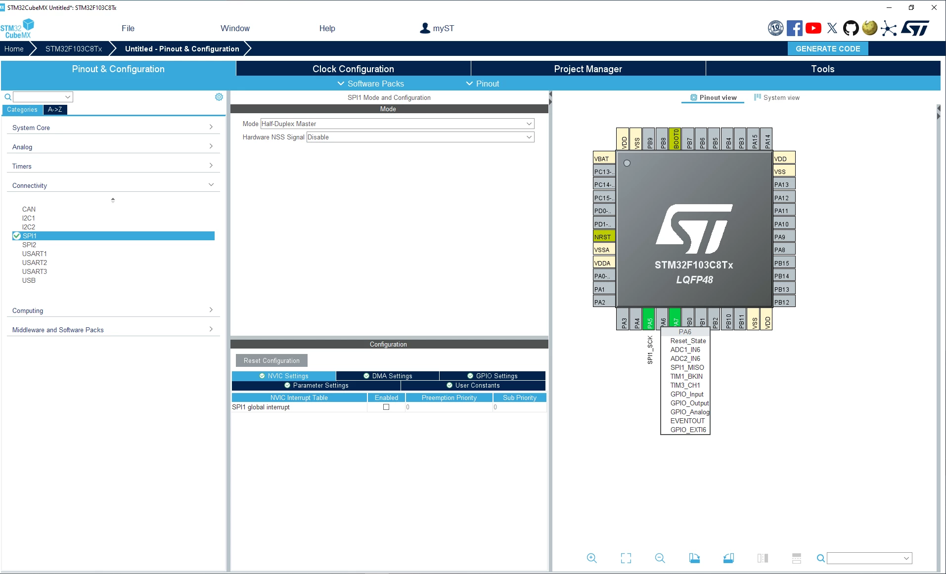

STM32F103C8T6 enables SPI1, but does not use MISO pin (PA6), can this pin reuse other functions? For
STM32F103C8T6 enables SPI1, but does not use MISO pin (PA6), can this pin reuse other functions? For example, timer function.

Hello @112233
If you are using the SPI1 without MISO (PA6) (in Half-Duplex Master), you can configure the PA6 on any of the modes mentioned on the screenshot:
Best regards.

The PWM output of the timer channel is reused. After SPI is enabled, the PWM output is not displayed.
