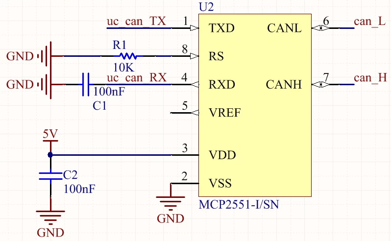

Posted on March 16, 2018 at 10:37
I forgot to say that, I used MCP2551 as CAN transceiver and I mounted this IC on the board like this(forget 100nF in RX, I hadn't assign true value for it at that time):0690X0000060A92QAE.png
and besides, I tested my code at loop-back mode in which, apparently, there is no need for external electrical connections, but I didn't get any result
About your question, I changed the code to this
  while (1)  {
        sprintf( (char *) hcan.pTxMsg->Data, ''%s'', msg );
        hcan.pTxMsg->DLC = strlen(msg);
        HAL_CAN_Transmit(&hcan,10);
and I didn't see any activity at mcu CAN output. After it, I unmounted the MCP2551 chip and put a 10K pull-up resistor and I checked it again and still no output!
T J
Senior III
March 16, 2018
Posted on March 16, 2018 at 13:39
I started with a third party transceiver, the CanDo unit.
I made it transmit every second, until I had the receiver working.
Then I worked on the transmitter code.

Have transceivers and something at the end of the cable to talk too, and respond/acknowledge reception.

Posted on March 16, 2018 at 10:40
No clive, but as I responded to T.J., I even tested the CAN in loop-back mode and I didn't get any result
