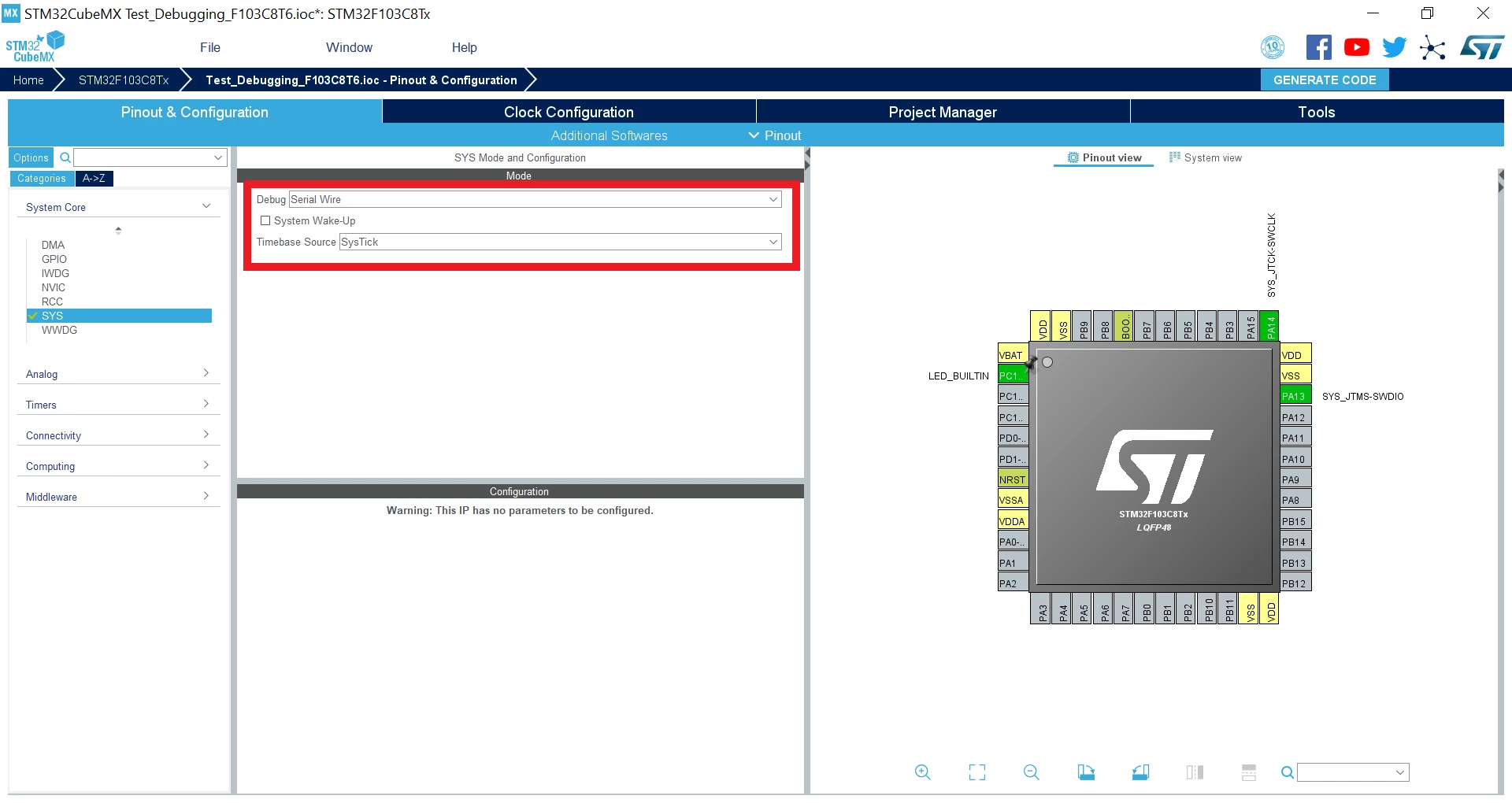

I'm trying to debug a simple application with the printf() function
  • Here's the CubeMX configuration:

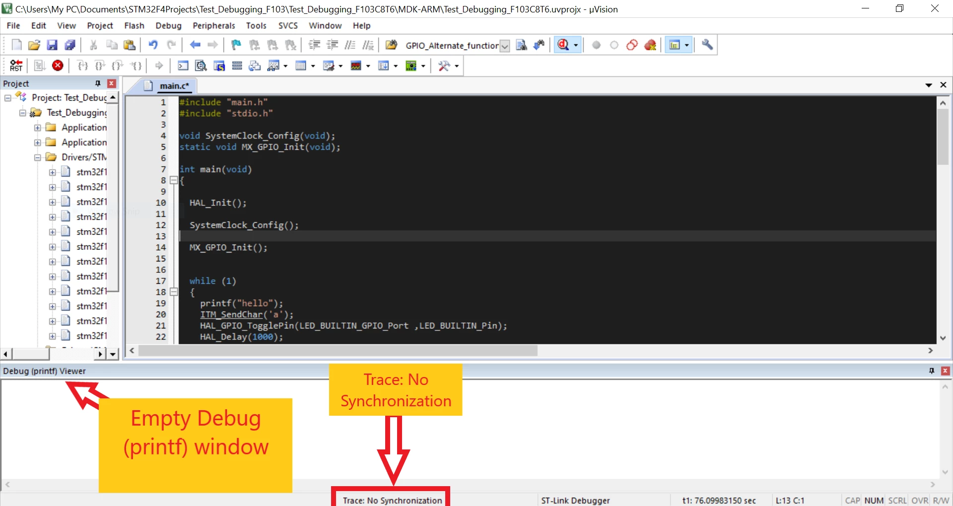

  • The Keil µVison configuration:
But it's not working when I start the debugger and I open the printf window it's empty and and I noticed a message below on Keil µVision "Trace: No Synchronization"
So, I hope you can help me and thank you in advance.

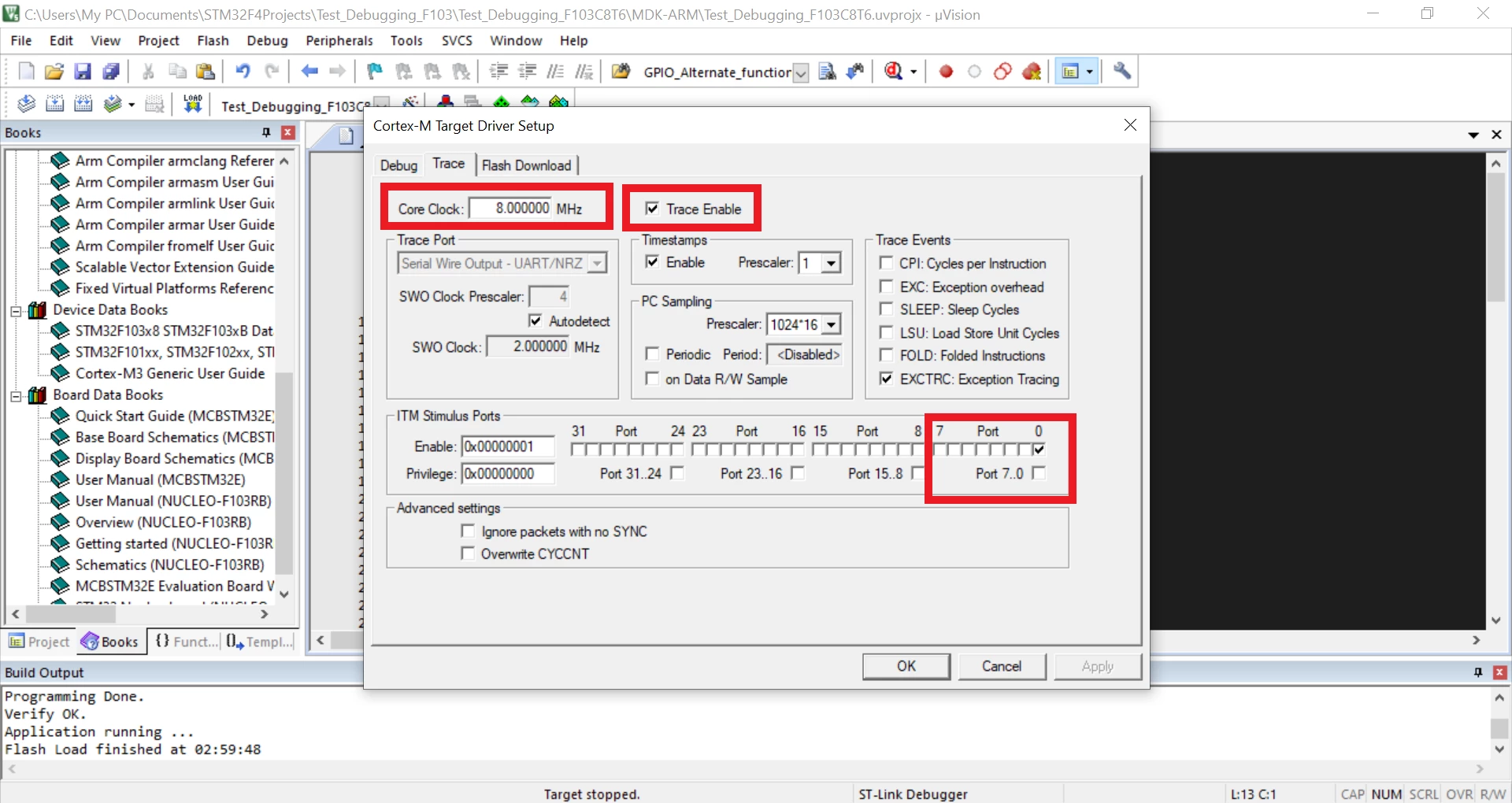

0693W000003CEdmQAG.pngHi KHADRAOUI Ibrahim ,
At first look at the problem seems like your code is missing:
In order to activate the ITM trace (printf) you need to add the fputc function definition just after the main function in your code as below:
 Write character to Serial Port
int SER_PutChar (int c) {
 ITM_SendChar (c);
 return (c);
int fputc(int c, FILE *f) {
 return (SER_PutChar(c));
You can add it in the main.c file, or do it in a separate file, usually called Retarget.c for MDK-ARM.
This should work, if not make sure you use the correct "core clock" in the MDK-arm options.
Also you can ceck with the User manual in case there is a hardware modification (switch, SB etc)

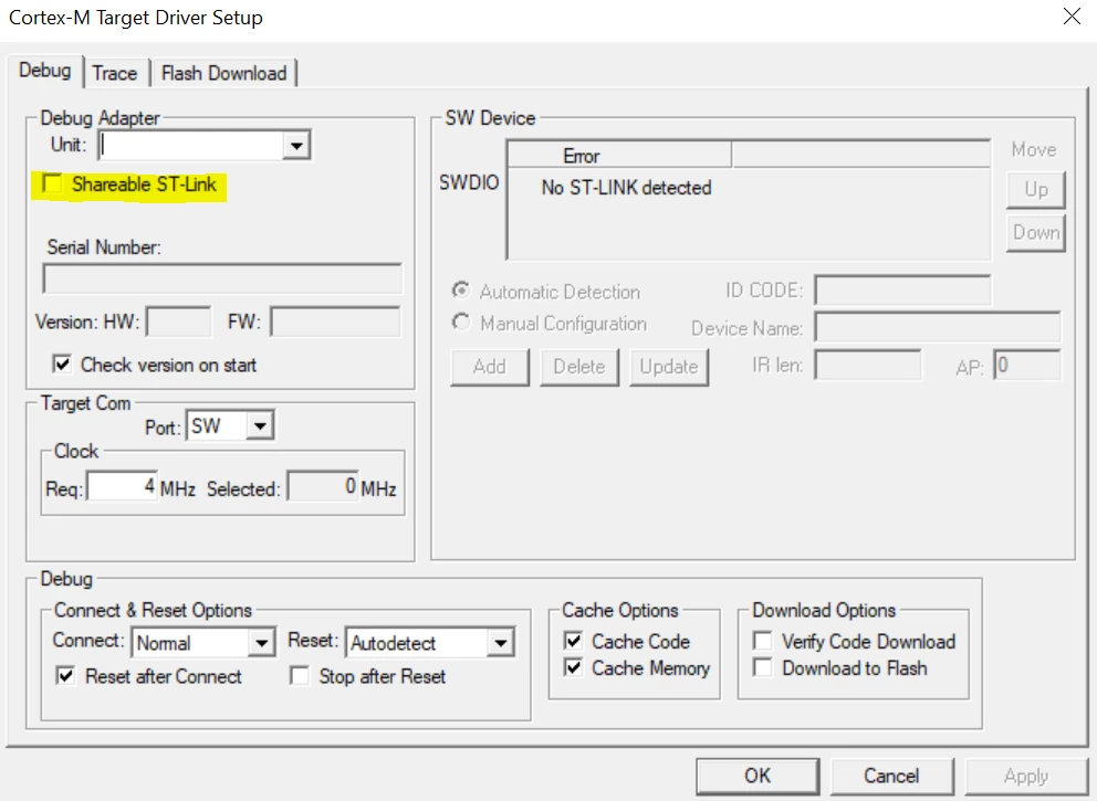

PS: The SWV is not supported when using ST-LINK Shared mode, so make sure it is not checked as in the photo I attached.
I hope this help!
-Imen

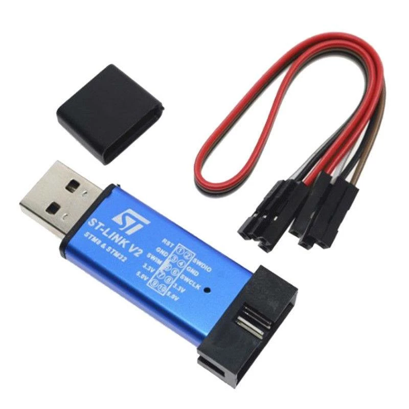

KHADRAOUI Ibrahim
Aug 6, 2020 11:03 PM UTC
Hi @Imen Ezzine​ !
Thank you for your reply.
I tried what you advised me, but it also doesn't work, However I tried with a stm32 discovery board with an integrated ST-LINK and it worked, I deduce that the ST-LINK that I used is a cheap Chinese one (on the photo above) is not compatible with the TRACE.
Regards.
