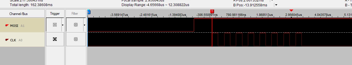

I try to run SPI 1 on STM32F103C8 but when i send data i have only SCK signal. MOSI(PB5) is in high state (dont change).

Yes I check this at first time.
HAL_GPIO_WritePin(GPIOB, GPIO_PIN_5, RESET);
HAL_GPIO_WritePin(GPIOB, GPIO_PIN_5, SET);
works ok (whene SPI1 is disabled)
I also replase MCU to new one.

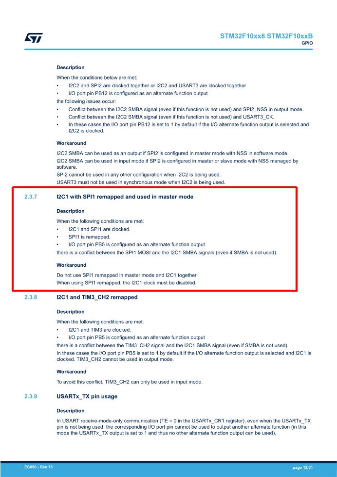

I found out what is causing the problem.
you can't have I2C1 enabled with SPI1 even if I2C1 pins are remapped
any way to bypass this problem?
waclawek.jan
February 3, 2023
Probably not in an easy way.
If you use I2C as master, you can try to bit-bang it.
You can consider using a different pin-compatible STM32.
