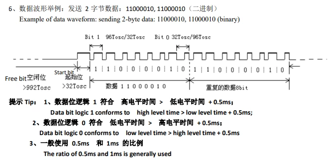

I'm using Timer_2 channel_1 PWM with DMA to generate the low polarity Pulse.
I set the value of PSC = 72, ARR = 2000 and Fosc = 72 MHz.
uint16_t TIM2_CCR1_Value[25] = {2100, 2100, 2100, 2100, 2100, 2100, 2100, 2100, 1200, 1500, 1500, 1500, 1500, 500, 1500, 1500, 1500, 1500, 500, 500, 1500, 1500, 1500, 1500, 500};
Explanation of above I given TIM2_CCR1 array value,
Free bit {2100, 2100, 2100, 2100, 2100, 2100, 2100, 2100} = {0, 0, 0, 0, 0, 0, 0, 0}.
Start bit 1200 mean 1.2ms off and 0.8ms on.
Data_0 {1500, 1500, 1500, 1500, 500, 1500, 1500, 1500} = {0, 0, 0, 0, 1, 0, 0, 0}.
Data_1 {1500, 500, 500, 1500, 1500, 1500, 1500, 500} = {0, 1, 1, 0, 0, 0, 0, 1}.

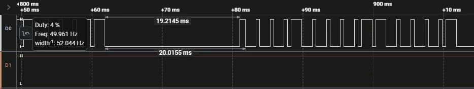

below I given the TIM2_CCR1 array values WaveForm,
0693W00000aJ1xGQAS.jpghere, Free bit and Start bit timing is 20.0155 ms. Data_0 and Data_1 totally 16 bit but i get only 15 bit. after I found that missing first bit data(value is 0).
I don't know where I made a mistake and how to slove this.

Try to change TIM2_CCR1_Value so that it displays some different sequence. Still missing one pulse?
March 16, 2023
@Community member​
Thank you for your comment and i change the
Free bit {2001, 2001, 2001, 2001, 2001, 2001, 2001, 2001} = {0, 0, 0, 0, 0, 0, 0, 0}.
but still missing one pulse(same problem).

0693W00000aIND8QAO.pngi try to achive this(above example) type of wave form.

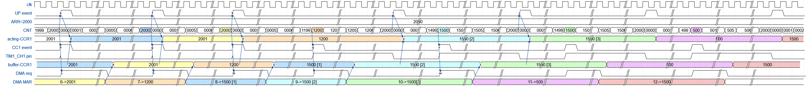

> TIM2->DIER |= TIM_DIER_CC1DE; //Capture/Compare 1 DMA request enable
No. Use TIM_DIER_UDE.
waclawek.jan
March 19, 2023
CNT acting-CCR1 buffer-CCR1
1999 2001 2001 acting-CCR1 and buffer-CCR1 from
 previous DMA transfers
2000 2001 2001 CNT==ARR => update event,
 at the same time CC1 event
 (because CCR1>ARR)
 => request towards DMA
0 2001 2001 buffer-CCR1 was transferred to
 acting-CCR1 because of Update
 (because CCMR1.OC1PE=1)
1
5 2001 1200 it took some time for DMA to be
 triggered and perform transfer
 - maybe not 5 timer ticks, but
 lets say this is a good rough
 estimate - so buffer-CCR1 now
 holds the new value DMA moved
 from the array in memory
1999 2001 1200
2000 2001 1200 CNT==ARR => update event,
 (because CCR1>ARR)
0 1200 1200 buffer-CCR1 transferred to
 acting-CCR1
1 1200 1200
5 1200 first 1500 DMA transferred the first 1500
1190 1200 first 1500
1200 1200 first 1500 CC1 event => request towards DMA
1205 1200 second 1500 DMA transferred the second 1500
 -- note, that the first 1500 is
 at this point overwritten without
 having been used
2000 1200 second 1500 CNT==ARR => update event
0 second 1500 second 1500 buffer-CCR1 transferred
 to acting-CCR1
etc. - in this period, pulse is output at 1500 as expected,
but there were two DMA transfers in the previous period
thus one value (the "first 1500") was already "lost",
which is exactly what was observed
Using Update for DMA triggering, instead of CC1, ensures
that there is exactly one DMA transfer each period,
avoiding this problem.

Another take (created using https://wavedrom.com/ an impresive free online waveform "drawer"), maybe more illustrative ?
0693W00000aJU4tQAG.pnga, f, k, t, y -- when CNT==ARR, CNT is zeroed and UPdate event is generated
d, i, n, u, z -- UPdate event causes the value from buffer-CCR1
 to be transferred into acting-CCR1
b, g, l -- if acting-CCR1>ARR, Compare (CC1) event is generated at UPdate
q, v -- if acting-CCR1<=ARR (as is usual), CC1 event is generated
 when CNT==acting_CCR1
c, h, m, r, w -- DMA is set so that it is triggered by the CC1 event;
 it takes some time until DMA fulfills the request by transferring data from
 memory to buffer-CCR1, here we used as an example 5 timer-cycles
e, j, o, s, x -- DMA transfers value from buffer in RAM into buffer-CCR1
 and increments the pointer into memory (DMA_MAR)
Note, that in the period between k and t there are two DMA transfers. This means,
that there's one less timer period than total DMA transfers, thus one less pulse
in the observed pulsetrain. The value 1500 from memory buffer position 8 (marked
as 1500 [1]) gets overwritten in the buffer-CCR1 by the next value (1500 [2])
before UPdate, i.e. it never contributes to pulse generation, so between
the 1200- and 500-pulse there are only two 1500-pulses, instead of three.
Remedy is simple, for PWM, perform the DMA-to-CCRx transfer upon UPdate event,
not upon the CCRx event. In that way, there's exactly one transfer per period.
CCRx buffering ensures that whatever the DMA transfer delay is, the new value
won't be used in this particular period, but in the next period (after the next
UPdate event transfers this value from buffer-CCRx into acting-CCR).
