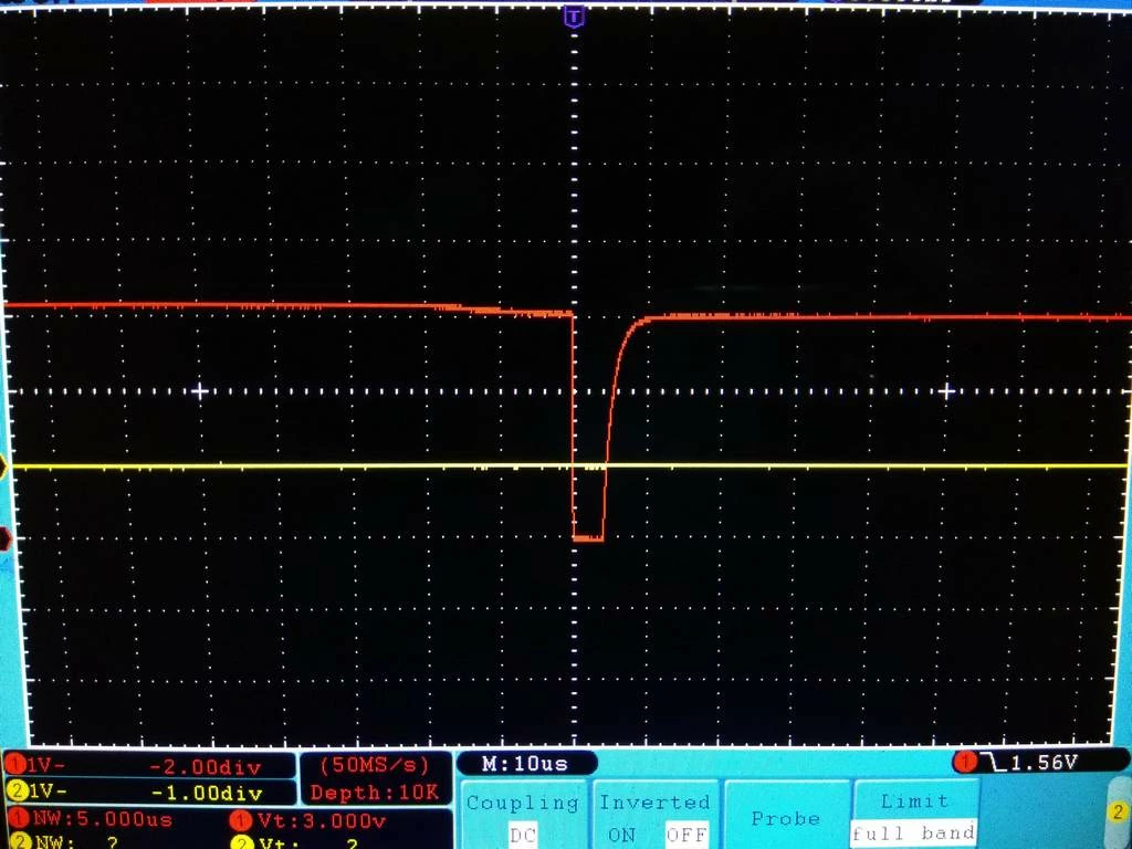

    waclawek.jan
    March 1, 2017
    Posted on March 01, 2017 at 11:13
    What re the SDA/SCL waveforms when looking by an oscilloscope or logic analyzer?
    mrtaotao789
    March 1, 2017
    Posted on March 01, 2017 at 18:12

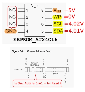

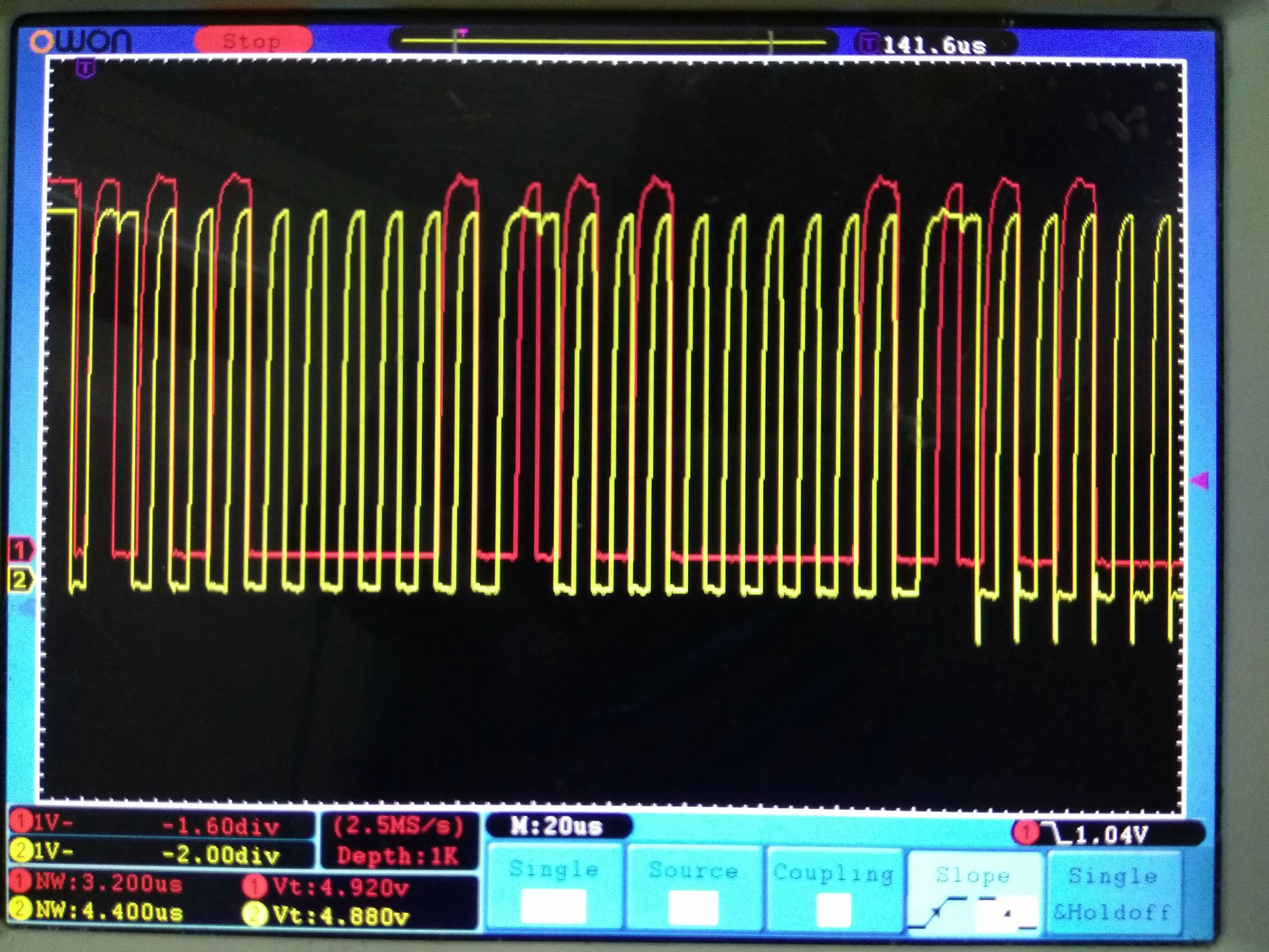

    S.Ma
    Principal
    March 2, 2017
    Posted on March 02, 2017 at 10:22
    The chip slave address A0 is NACK => either the slave address is wrong, or bad soldering, or SDA/SCL connection is wrong. If possible, probe the EEPROM package pins and make sure it has supply and ground ok.

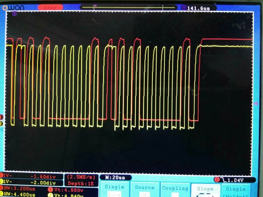

    mrtaotao789
    March 2, 2017
    Posted on March 02, 2017 at 11:58
    I think my soldering is ok, i checked  :)
    and this is datasheet of EEPROM
    but now, i don not understand
    what is mistake ??
    T_T!
    and latest, this is code :
    // I2C_HandleTypeDef *hi2c, DevAddress, Trials, Timeout
    //my_i2c_status = HAL_I2C_IsDeviceReady( &hi2c1, (uint16_t)0xA1, (uint16_t)10, 3000);
    my_dat = 0x55;
    my_get = 0x00;
    //I2C_HandleTypeDef *hi2c, DevAddress, MemAddress, MemAddSize, *pData, Size, Timeout
    HAL_I2C_Mem_Write( &hi2c1, (uint16_t)0x00A0, (uint16_t)0, (uint16_t)1, &my_dat, 1, 3000);
    HAL_I2C_Mem_Read( &hi2c1, (uint16_t)0x00A1, (uint16_t)0, (uint16_t)1, &my_get, 2, 3000);

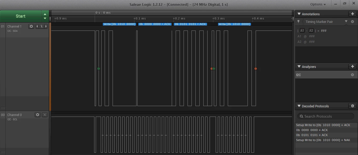

    and this is a capture from Saleae analyzer:
    in last lie of coding.. i set addr = 0xA1
    but it as 0xA0 on Scope.  O_o!
    i do not understand.
    Thank you very much
    _/\_

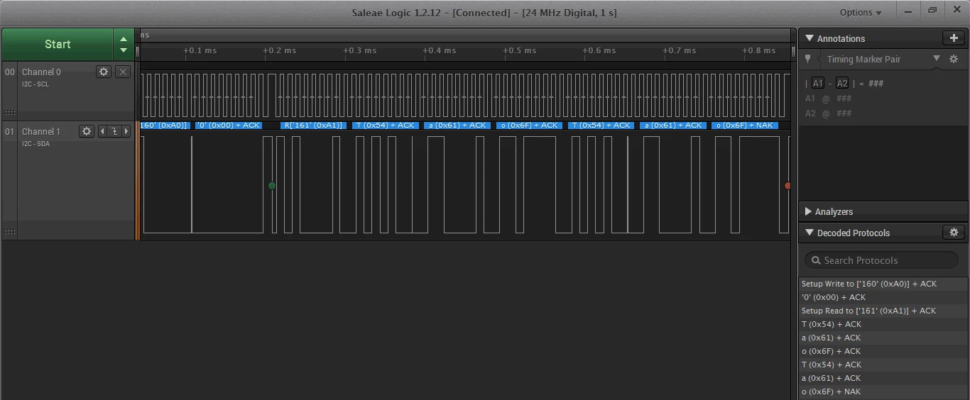

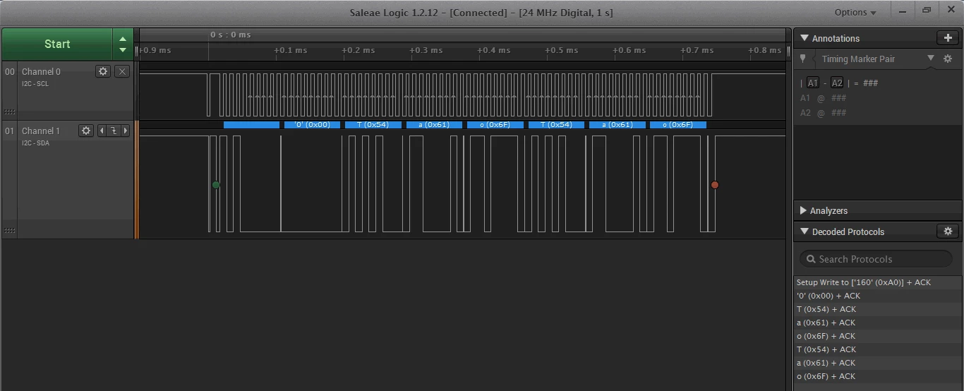

    mrtaotao789
    March 4, 2017
    Posted on March 04, 2017 at 06:55
    Now, i can solve i2c,
    Lib from HAL..
    HAL_I2C_Mem_Read() :
    Algorythm of HAL_Lib is not mathing with EEPROM, so it can not use
    i coding easy functions for solve this problem and oscillope by Saleae Logic Analyzer,
    i follow timing diagram of RM0008 of STM and data sheet of EEPROM
    Now it work..
    but HAL_I2C_Mem_Write() : it is correct, it can use
    thank you every body :)
    ___/\___0690X00000606IMQAY.png0690X00000606OiQAI.png
