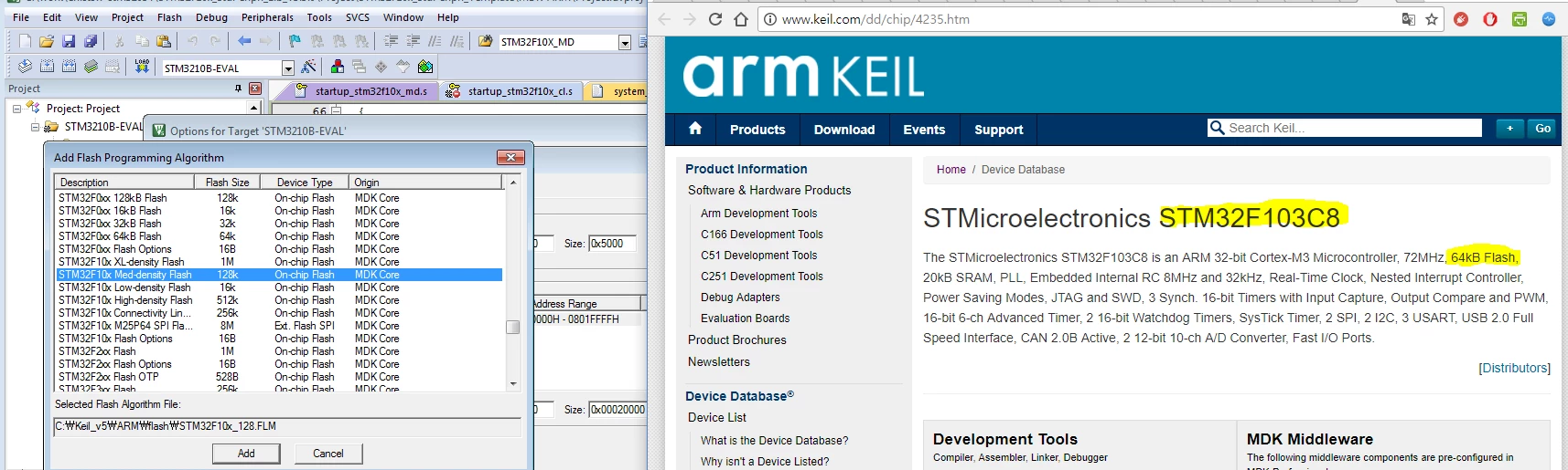

STM32F103C8 does not have correct flash model.
  • September 15, 2017
  • 1 reply
  • 490 views
Posted on September 15, 2017 at 09:41
Hi
I'm curious which one is correct item.
I would like to select the correct memory model to STM32F103C8
But I can't see anywhere
Could you help me what am I supposed to do in this case?

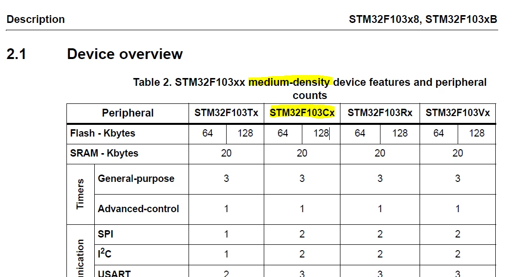

    Hi.
    You made the correct choice.
    Your device is medium density and you choosed the medium density F10x device.
