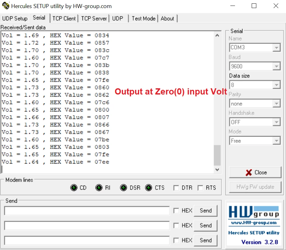

STM32f103c8 ADC error, Constant error value( 1.69 Volt) and erratic output
I am trying to create ADC using STM32F103C8. Software i am using are:
a. STM32CubeMX
b. Keil Vision -- V5
c. Hercules to Monitor the Serial Output
Clock Setting of STM is 72 Mhz and 12 Mhzfor ADC
Code :-
while (1)
   /* USER CODE END WHILE */
      HAL_ADC_Start(&hadc1);
      HAL_ADC_PollForConversion(&hadc1,300);
      raw = HAL_ADC_GetValue(&hadc1);
      float vin = (double)raw*(3.3/4096);
      sprintf(msg1,"Vol = %.2f , HEX Value = %.4x \r\n",vin, raw);
      HAL_UART_Transmit(&huart1,(uint8_t*)msg1,sizeof(msg1),300);
   HAL_Delay(1000);
   /* USER CODE BEGIN 3 */
i am getting a constant DC Output of around 1.69 Volt, when input volt at ADC is Zero (Screen Shot attached). After supplying any Voltage value between 0 - 3.3 Volt, output is varying contentiously between 0 to 3.3 Volt.
I have checked the input reference volt, it is 3.3 Volt. Can you suggest me how to resolve this issue. I have printed a HEX value of output of function HAL_ADC_GetValue(&hadc1). 0693W00000Czv6kQAB.png
I guess, you've left the input floating (unconnected) - ADC output is then undefined.
Zero input means, that the input is connected to ground.

Thanks for the Reply. Your suggestion work perfectly.
