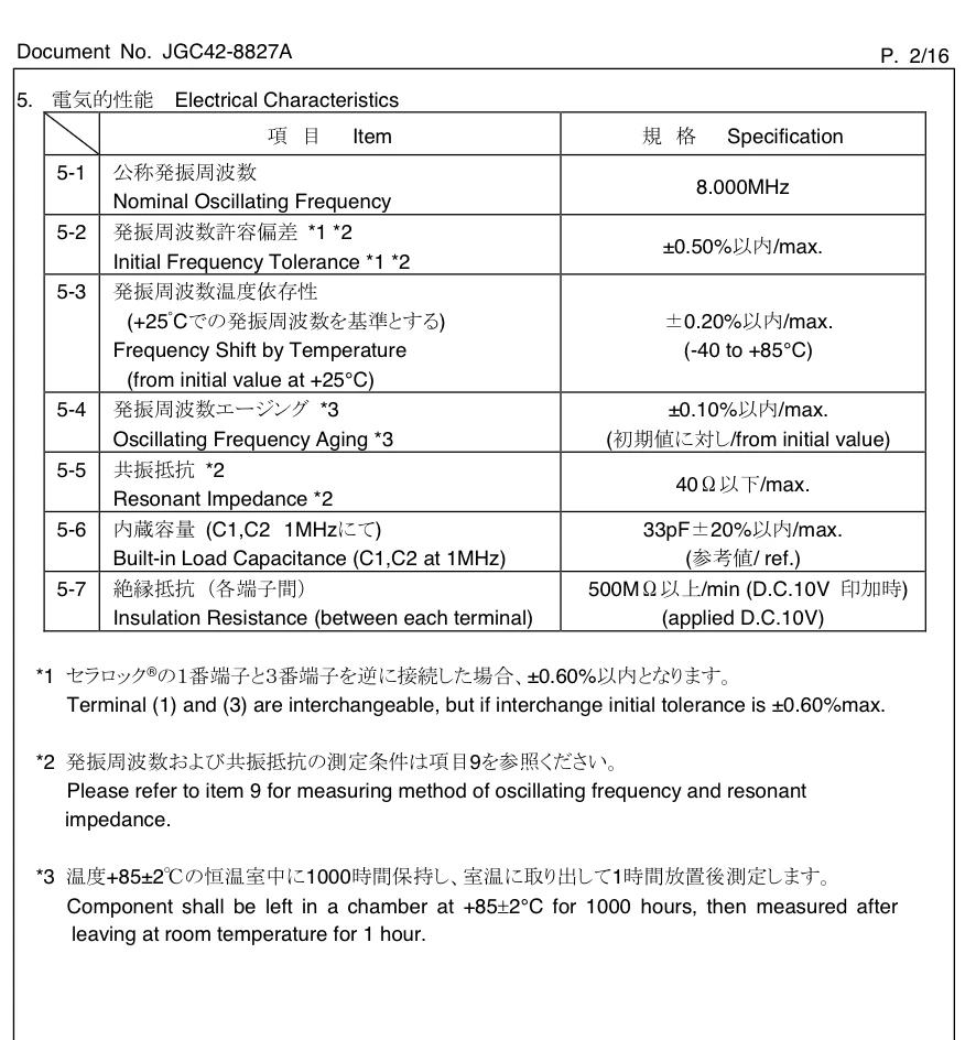

Dear @pilot ,

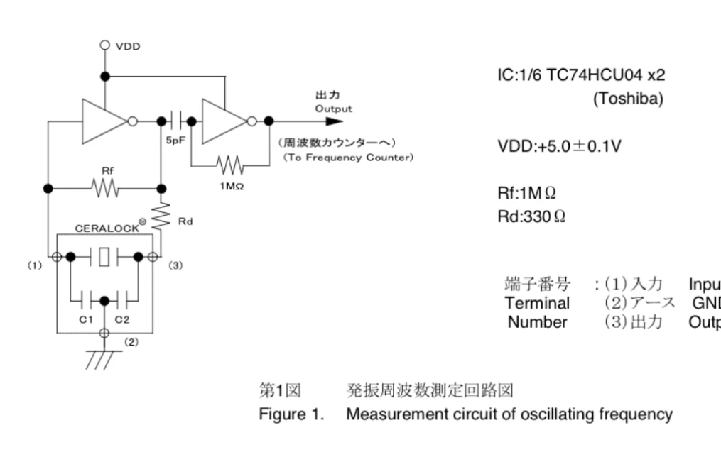

Resonators are a bit different from Crystals as they have their built-in CL1 and CL2, this murata resonator has 33pF C1/C2 which is different from Crystal CL . In general CL1/CL2 value are in range of twice for crystal for the value of CL  - Stray /Parasitic .
Here this resonator is fully compatible with STM32F1 series . You can use no worries.
You can also refer to our Application Note :
https://www.st.com/resource/en/application_note/an2867-guidelines-for-oscillator-design-on-stm8afals-and-stm32-mcusmpus-stmicroelectronics.pdf#
I’m interesting to know the end application usage, this resonator has 8MHz ( -/+ 0.5%) you can use built-in HSI .
Hope it helps ,
STOne-32.

Thank you, will test. Startup time is not an issue, nor is the frequency precision very important.
