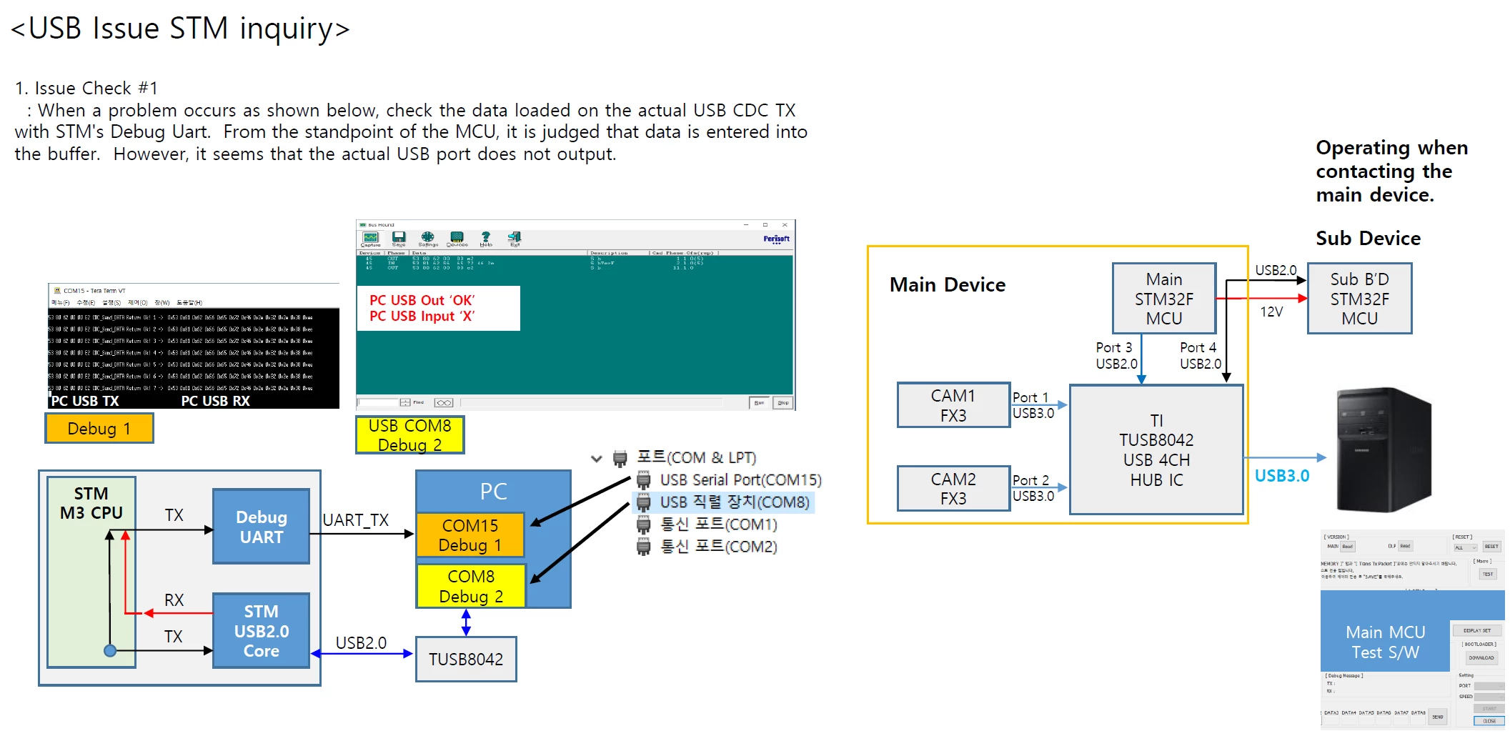

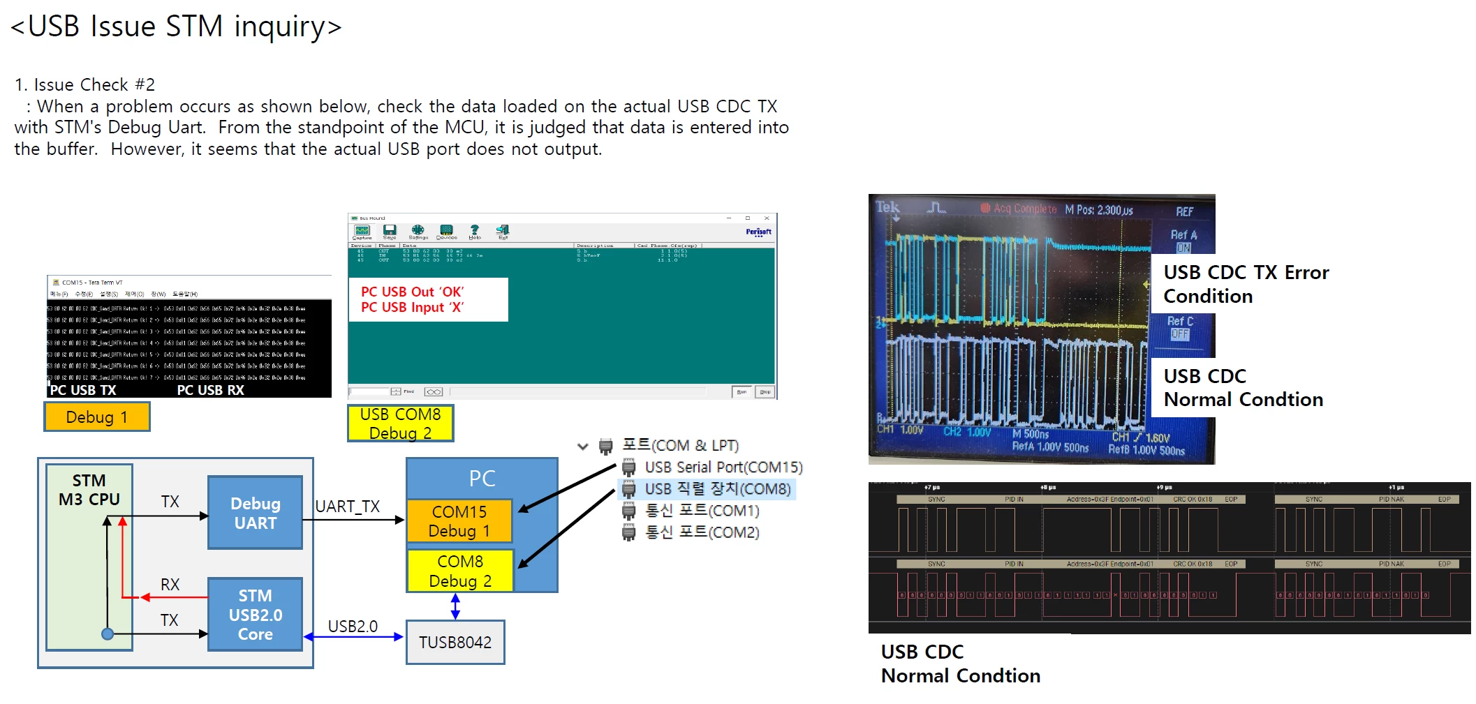

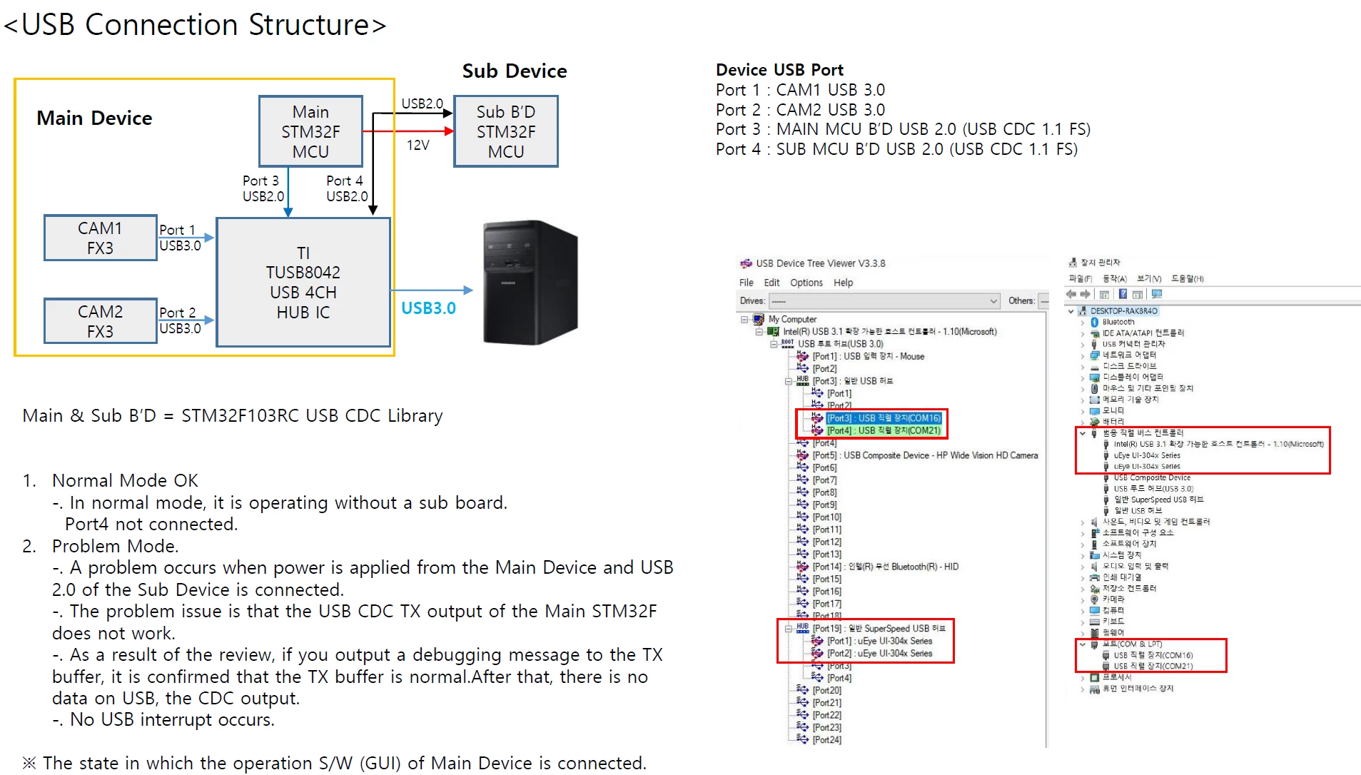

STM32F103 USB CDC TX Error Issue.
If the Sub device is connected as below, the USB CDC TX output of the Main device does not work.
Please refer to the information below.
I don't know the reason.
