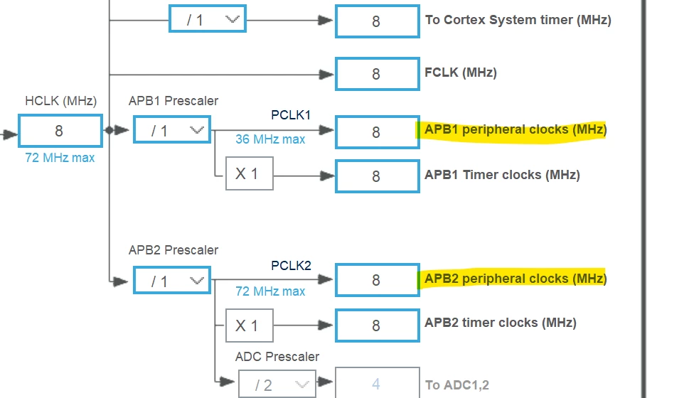

I am working on a project that uses STM32F103 and STM32G4 as MCUs. They need to communicate between each other using UART. I am trying to configure STM32F103 UART clocks to match the STM32G4's clocks but I have not been able to figure out where to do that. I found a document that says UART clock is based on HCLK, but is there any prescaler that configures the UART clocks? If not, what is the frequency the UART clocks are based in so I can match it by configuring the STM32G4s clock, instead.
To be more specific, I am using all ports as asynchronous. USART1, USART2, USART3, UART4, and UART5.

In general, a UART will use a fractional-n divider to generate a baud-rate-clock from the incoming clock (which may be a PCLK - either PCLK1 or PCLK2 depending which UART) or HCLK or SysClk. I expect G4 to also support clocks directly from the HSI/HSE oscillator so that the baud-rate does not need to be recalculated should you change the CPU speed on-the-fly to save power when there isn't much processing to do.

Start a project in CubeMX and look at the Clock Configuration tab to understand the various clocking options. It's in the RM as well, but is faster to get to and understand in CubeMX.

I did. I guess I am not understanding what configuration option controls the UART/USART clocks. When using STM32G4 I was able to use CubeMx to set the USART/UART clocks at different frequencies. For now, I am setting all clocks to 16MHz, but with STM32F103 I am not able locate where to adjust the USART/UART clocks to match the 16MHz. I guess I can use my oscilloscope and play around with the configurations but it would save me a lot of time to understand what is happening.
Jul 23, 2024 9:04 PM UTC
On the STM32F103, the clock feeding USART is either PCLK1 or PCLK2 depending on where the peripheral is. There is no option to change it to anything else.
Why?
There is absolutely no need to do that!
You don't fiddle with your PC's clock to have it communicate over UART, do you?!
All that matters is that the baud rates match.
(and, as @Pavel A. said, the STM32G4 can even do  automatic baudrate detection)
