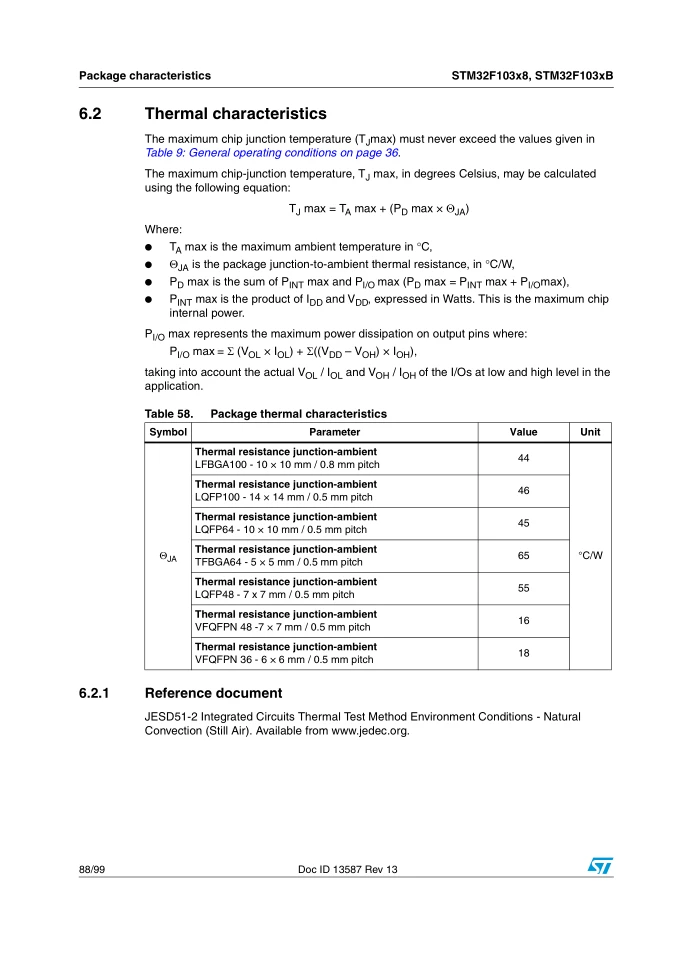

I'm using STM32F103CBU6TR and I can't find the thermal resistance (j-C).

0693W00000WJrrsQAD.pngJunction-case thermal resistance may be misleading in cases, where the heat transfer through pins dominates, which may quite well be the case of STM32, too.
