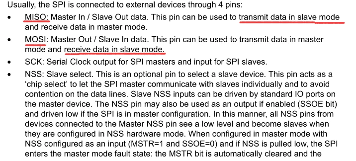

According to the
RM0008.pdf
, when spi in slave mode the MISO pin is transmit data, the MOSI pin is receive data.
But according tests and the example
STM32F10x_StdPeriph_Lib_V3.5.0\Project\STM32F10x_StdPeriph_Examples\SPI\Simplex_Interrupt
that is not true.
The truly is MISO is receive data.
   Which is error?  document? chip?
#spi #stm32f103 #bug

MISO = Master mode as Input, Slave mode as Output
MOSI = Master mode as Output, Slave mode as Input
