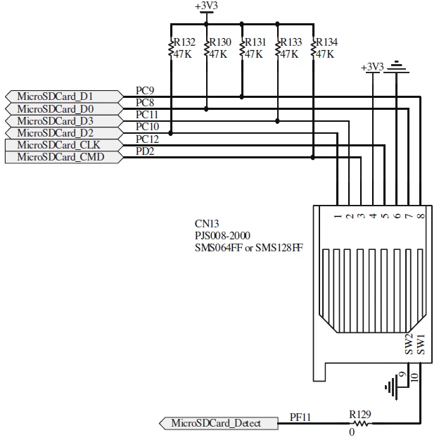

Hi all,
I've a problem with my STM32F103. I need to use fat filesystem on SD card to read/write/create files.
I've connected the SD card to the SDIO interface and 4 wires mode with 47Kohm pull-up on cmd and data pins.
I tried to use Chan FatFs module but it didn't working.
When I debug the f_open(), inside the check_fs() function can't retrieve 0xAA55 on boot sector, and the function returns NO_FILE_SYSTEM.
I've tried different SD card but the result was always the same. The clock of the board is 72MHz. I've read other discussions on this forum without luck.
Can someone help me?
Thanks.
Update1: The check_fs() method call the low level SD_ReadBlock() and here, where the code try to set the block size for the card, it returns SD_CMD_RSP_TIMEOUT.
#stm32f103-fat-sdio

Posted on May 19, 2014 at 16:31
Which specific STM32F103 part are you using?
What board are you using?
Can you draw a schematic of the socket connectivity?
What cards are you using MMC, SD, SDHC, MicroSD, etc?
What capacity?
What low level software are you using to access the cards?
Some ST Library?
Yes, you should verify the low level SD access functions before integrating FatFs on top.
Check the pin configurations, and SD_Init() code.
Check if the 1-bit access mode at 400 KHz is actually working and pulling device geometry from the card.

Posted on May 20, 2014 at 08:29
Hi Clive and thanks for the reply.
I'm using an STM32F103VE in a custom board (attached there is the schematic for the SD connection).
I'm using 2 different cards with the same specification: SDHC 4GB class 4.
The low level software used for access the card is sdcard.c fromMCD Application Team of STMcivroelectronics.

In fact, inside theSD_Init(), the functionSD_PowerON() method returns ''SD_CMD_RSP_TIMEOUT'' when it sendsCMD8 to verify SD card interface operating condition.The SD_CLK clock is about 370KHz.
How can I test the sd low level software before integrate it in the FatFS code?
Thank you very much.

And the supply is enabled?

Hi Clive
thanks for the answers.
At the end the problem was only the SD card connector (form Molex) whose pins were not good contact when the card was inserted.
Thanks for advice.
