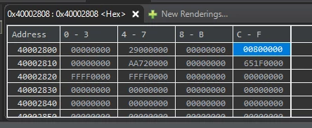

I'm facing some issue regarding the RTC peripheral of the STM32F103.
In particular, apperently, the RTC seems to randomly loose the configuration given:
  • The RTC device is always powered, and configuration is done ideally only once (except in case of reset)
  • Both the RTC Vbat and VDD comes from the same power supply rail (when in standby it comes from a tadiran lithium battery backed up with a 100mF supercap)
  • I'm setting the RTC with a prescaler value of 32 to have a tick of almost 1 ms
  • Sometimes on some samples it happens that the RTC is not counting at 1 ms anymore but it in fact counts every seconds
By attaching with the debugger to a running target device with this problem I found out that the prescaler value seems to be set at the default value 0f 0x8000:
The initialization code is as follow:

In the above code, at each point where RTC is initialized, toggle a pin, or output diagnostics to any interface, or write a diagnostic variable observed later by the debugger. Also, add a check for the proper value of the prescaler, after this routine. Do this, in order to find out the source/reason for the problem.

as you suggested, I set a trap detecting the condition of prescaler different from 32.
I also set a trap inside the HAL_RTC_Init function.
However after two days of testing I had no luck and no GPIO were asserted.
Are there some other condition that may cause a reset of the peripheral to the default value? I don't think this is the case, but is it possible that the RTC counter timer register (CNTL and CNTH) overflowing might cause some issue?
