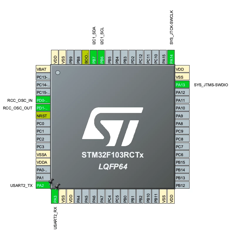

Hi, I am a beginner user of the stm32 board.
I am working with an ICM20607 IMU sensor, and I want to read the accelerometer data (x, y, z axes) using the Cube IDE.
I ve read a lot of sources for one week but couldn't find a way to fix it. I can't see something on my serial port. What am I missing? Thank you.

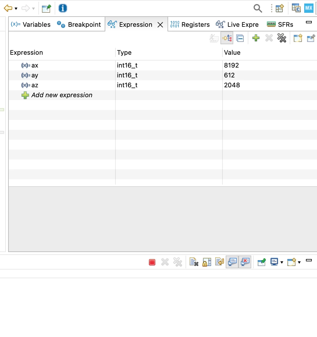

Ok, but what DOES happen?
Do the I2C functions read anything? Do they return error or status codes?
Can you read any of the STATUS or WHOAMI registers?
How's this wired? You have external pull-ups?
You have this sensor on a board? You've looked at the signals with an oscilloscope or logic analyzer?
October 12, 2024
yes, this imu sensor is on the board. I don't have any wiring on board. Do I need it? Do I need to check signals? the board is new, and I run another code on it without issue.
there is no warning or error for the code.
I only see these. , ax - ay- az

So you have data and you're trying to send over huart2. So how is UART2 connected to the outside world? What are you using to view this data? Baud rate match both ends?

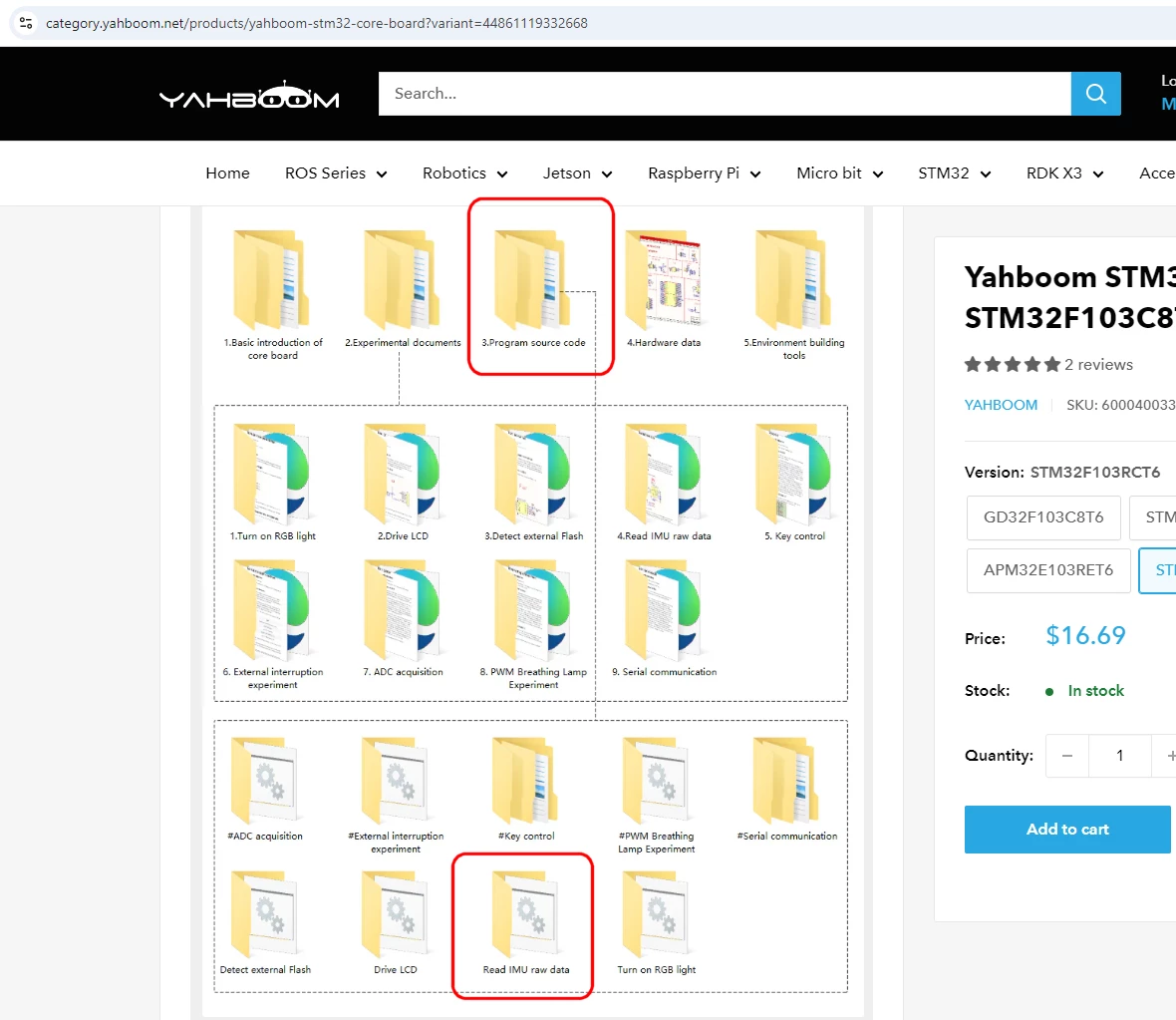

Have you tried the supplied code?
