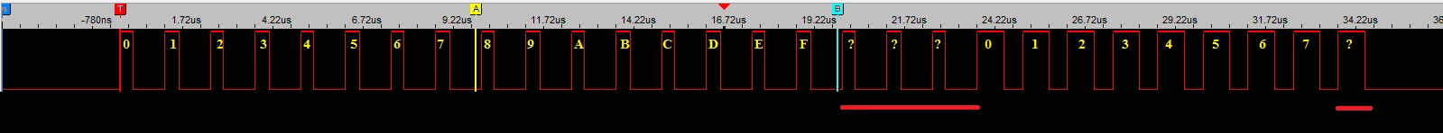

I have STM32F103 working on 8MHz.
If I InitPWM on Ch1 Tim3
void MX_TIM3_Init(void)
TIM_ClockConfigTypeDef sClockSourceConfig;
TIM_MasterConfigTypeDef sMasterConfig;
TIM_OC_InitTypeDef sConfigOC;
htim3.Instance = TIM3;
htim3.Init.Prescaler = 0;
htim3.Init.CounterMode = TIM_COUNTERMODE_UP;
htim3.Init.Period = 9;
htim3.Init.ClockDivision = TIM_CLOCKDIVISION_DIV1;
HAL_TIM_Base_Init(&htim3);
sClockSourceConfig.ClockSource = TIM_CLOCKSOURCE_INTERNAL;
HAL_TIM_ConfigClockSource(&htim3, &sClockSourceConfig);
HAL_TIM_PWM_Init(&htim3);
sMasterConfig.MasterOutputTrigger = TIM_TRGO_RESET;
sMasterConfig.MasterSlaveMode = TIM_MASTERSLAVEMODE_DISABLE;
HAL_TIMEx_MasterConfigSynchronization(&htim3, &sMasterConfig);
sConfigOC.OCMode = TIM_OCMODE_PWM1;
sConfigOC.Pulse = 1;
sConfigOC.OCPolarity = TIM_OCPOLARITY_HIGH;
sConfigOC.OCFastMode = TIM_OCFAST_DISABLE;
HAL_TIM_PWM_ConfigChannel(&htim3, &sConfigOC, TIM_CHANNEL_1);
and star ti with
HAL_TIM_PWM_Start_IT(&htim3, TIM_CHANNEL_1);
all working OK and output generate 125ns pulse on 800kHz (1.25us) If replace Start_IT with DMA version
uint32_t pData[1]={6};
HAL_TIM_PWM_Start_DMA(&htim3, TIM_CHANNEL_1,pData,1);
all working OK and output generate 70ns pulse on 800kHz (1.25us),but if use
uint32_t pData[16]={3,3,3,3,3,3,3,3,0,0,0,0,0,0,0,0};
HAL_TIM_PWM_Start_DMA(&htim3, TIM_CHANNEL_1,pData,16);
this genreate 375ns its OK but frequency is 400kHz(2,5us) If I trace and look on reg CCR1 I see 3,0,3,0,3,0,3,0,3,0,3,0,3,0,3,0

    asrock70
    asrock70Author
    November 28, 2015
    Posted on November 28, 2015 at 16:47
    Thanks you . With half word you have tue,
    According to my
    htim3.Init.Period = (clock of timer / output frequency)-1
    htim3.Init.Period = ( 8MHz/ 800kHz)-1  htim3.Init.Period = 9 is correctly.  However, I foundanother problém.  /* TIM3 init function */
    { TIM_ClockConfigTypeDef sClockSourceConfig;
    TIM_OC_InitTypeDef sConfigOC; htim3.Instance = TIM3;
    HAL_TIM_Base_Init(&htim3); sClockSourceConfig.ClockSource = TIM_CLOCKSOURCE_INTERNAL;
    HAL_TIM_ConfigClockSource(&htim3, &sClockSourceConfig); HAL_TIM_PWM_Init(&htim3); sMasterConfig.MasterOutputTrigger = TIM_TRGO_RESET;
    HAL_TIMEx_MasterConfigSynchronization(&htim3, &sMasterConfig); sConfigOC.OCMode = TIM_OCMODE_PWM1;
    sConfigOC.Pulse = 0;
    HAL_TIM_PWM_ConfigChannel(&htim3, &sConfigOC, TIM_CHANNEL_1); } uint16_t pData[25]={3,3,3,3,3,3,3,3,3,3,3,3,3,3,3,3,6,6,6,6,6,6,6,6,0};
    HAL_TIM_PWM_Start_DMA(&htim3, TIM_CHANNEL_1,(uint32_t*)pData,25);   I thing, this send 16x Log1 375ns /Log0 875ns + 8x Log1 750ns / Log0 500ns  but hw logic analyser show this 0690X00000605JvQAI.png
    Timing
    is OK, but problem is in
    the number of pulses
    instead of 16 short have 19 short pulses and
    instead of8long have 9 long pulses
    Which
    could be the
    problem?
    Tesla DeLorean
    Guru
    November 28, 2015
    Posted on November 28, 2015 at 18:24
    Try running the buses/CPU faster, and ensure the pattern buffer is in RAM
