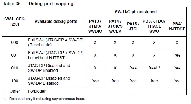

did anyone ever manage to get PB3 working as an I/O port on an STM32F103?
I am having a hard time with the F103VB where I need PB3 as input - no matter what I try, PB3 simply is returning a 0 value.
AFIO->MAPR is set to SWD debug only, JTAG off (and AFIO clock is on, of course).
I also explicitly set DBGMCU_CR to turn TRACE off, although that should be default after reset.
The other two related port pins (PB4 and PA15) work perfectly fine as GPIO. Only PB3 simply appears dead.
The errata sheet also doesn't mention any problems with PB3 as GPIO.
Did I find a new bug?
Any help is greatly appreciated.
Thanks, Tilmann

    In 'STM32F1 getting started hardware development' application note , you can see that PB3 is used by the SW debug port. PB5 and PA15 are only used by JTAG, this is why you can use them as GPIO pins by disabling the JTAG and keeping the SWD enabled.
    If you want to use PB3 pin, you must also disable the SWD.
    Lawliet.
    That really isn't what the RM0008 manual says...
    _dalbert
    February 8, 2019
    Agreeing with Clive: this isn't true, you do not need to disable SWD. You want option 2 (SWJ_CFG=010 -> JTAG-DP Disabled and SW-DP Enabled) in the above table. I use PB3 and PB4 as GPIO with SWD enabled.

    If you want to use the PB3 as a GPIO pin, you should not use the asynchronous trace over the SW debug.
    Lawliet.

    problem solved - indeed it was a small typo in the MAPR assignment, so in fact JTAG was not disabled in the application code. The bootloader didn't have that typo, so JTAG was disabled there, but during initialization of the application all peripherals are reset - and it appears that this partially resets the JTAG port assigment... (Remember that PB4 and PA15 still worked as GPIO, that's why I didn't notice that typo for such a long time (and obviously I overlooked it very many times when checking the code)).
    Sorry, my fault. Now PB3 works as expected.

    Remember that particularly these bits of MAPR are write-only, unfortunately.
    Tilmann

    You can indeed use PB3 and PB4 as GPIO pins provided you do not need their default TRACESWO and NJTRST functions (which you don't for most ST-Link V2 debugging). The following code is tested and works.
     // Release PB3/TRACESWO and PB4/NJTRST from control of the
     // Debug port so they can be used as GPIO pins
     DBGMCU->CR &= ~DBGMCU_CR_TRACE_IOEN;
     RCC->APB2ENR |= RCC_APB2ENR_AFIOEN;
     AFIO->MAPR |= AFIO_MAPR_SWJ_CFG_JTAGDISABLE;
