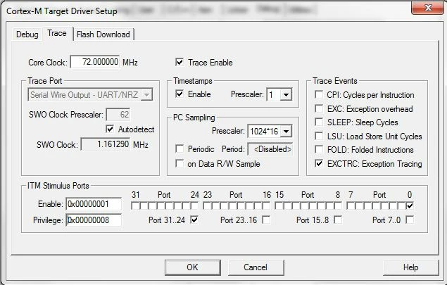

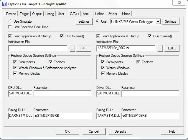

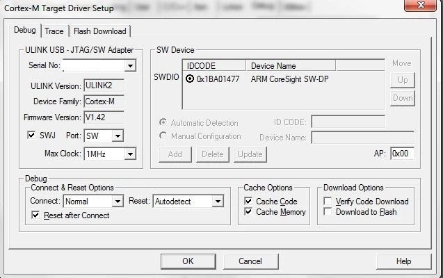

First of all debugging window :

} Finally after checking many samples and the documentation, I have made an .ini File (see above) which is used at debug startup :
FUNC void DebugSetup (void) {
// <h> Debug MCU Configuration
//   <o1.0>    DBG_SLEEP     <i> Debug Sleep Mode
//   <o1.1>    DBG_STOP      <i> Debug Stop Mode
//   <o1.2>    DBG_STANDBY   <i> Debug Standby Mode
//   <o1.5>    TRACE_IOEN    <i> Trace I/O Enable
//   <o1.6..7> TRACE_MODE    <i> Trace Mode
//             <0=> Asynchronous
//             <1=> Synchronous: TRACEDATA Size 1
//             <2=> Synchronous: TRACEDATA Size 2
//             <3=> Synchronous: TRACEDATA Size 4
//   <o1.8>    DBG_IWDG_STOP <i> Independant Watchdog Stopped when Core is halted
//   <o1.9>    DBG_WWDG_STOP <i> Window Watchdog Stopped when Core is halted
//   <o1.10>   DBG_TIM1_STOP <i> Timer 1 Stopped when Core is halted
//   <o1.11>   DBG_TIM2_STOP <i> Timer 2 Stopped when Core is halted
//   <o1.12>   DBG_TIM3_STOP <i> Timer 3 Stopped when Core is halted
//   <o1.13>   DBG_TIM4_STOP <i> Timer 4 Stopped when Core is halted
//   <o1.14>   DBG_CAN_STOP  <i> CAN Stopped when Core is halted
// </h>
 _WDWORD(0xE0042004, 0x00000027);  // DBGMCU_CR
DebugSetup();                       // Debugger Setup
Now when I use printf in my software, it will pass on the instruction and get into putc function, but nothing will come out on the debug printf in Keil.
If anyone has an idea of what could cause this, that would be VERY appreciated :)
