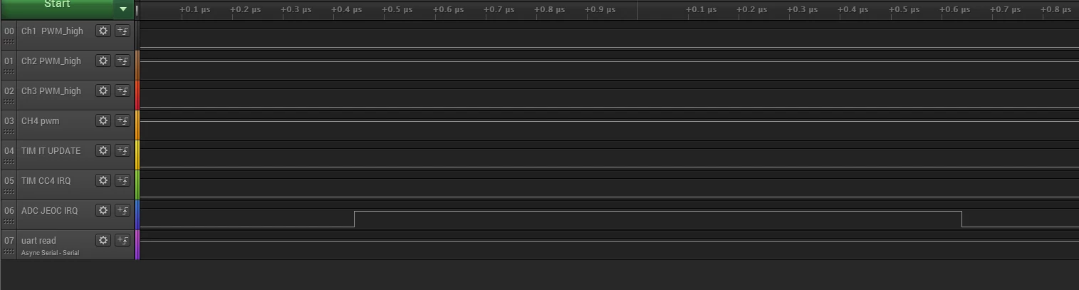

My ''without USART''  ADC interrupt handler.... looks like this ,   on the logic analyzer judging by the gpio toogle time, this routine runtime takes arround 1us to run.

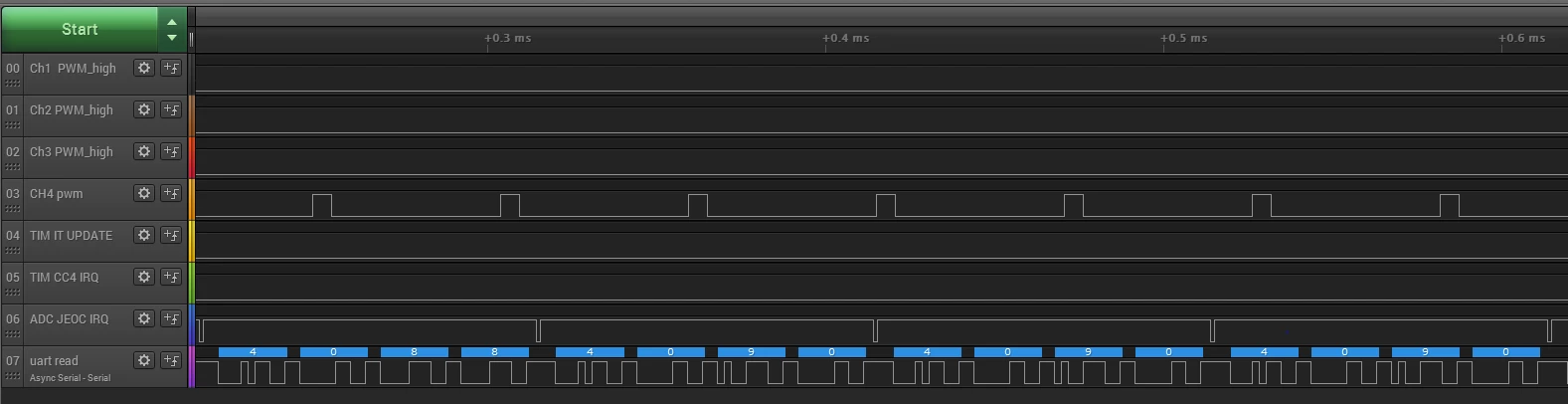

But... i want to send the ADC value to my pc using usart connection... so i had some usart function inserted into the adc jeoc event....
So after each injection end of conversion... i  send the data via usart at a baudrate of 460800bps... but i want the full 16bit value to be sent to the pc...
Ok said and done,   the adc channel is tied to a 3.3v signal,   on the usart i have 4093 decimal which is corect if i do the math...
But the problem which occures is the increase of adc irq handler runtime from 1us to 100us which is huge
.... and its screwing up my pwm signals ( see screenshot bellow)0690X00000606DuQAI.png
The adc channel is reading a shunt resistor which is coming from a 3 phase FET stage for a bldc, so i need feedback to the pc as fast as posible....
For example if i send usart to the pc which  takes 100us... in this time  i will have many pwm pulses where i can have overcurrent fault....
So i need to send feedback as fast as posible when reading the first pwm pulse on each of the 3 phases (or 3 pwm high side signals)
Is it posible to send usart data faster? without afecting the adc irq timing?  Some ideas would be wellcomed
Thanks

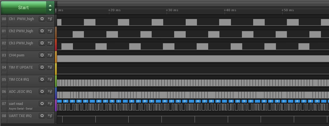

    Don't put blocking USART code in the IRQ Handler. Put it in a buffer served by the USART TXE IRQ.

    Yes, but you'd still need to ensure that the DMA buffer has vacated before starting another, or queue one up. The bandwidth will be limited by the USART baud rate.

    Ok... so i am guessing either i use DMA or using USART to handle the events.... i will get the same result... but it will not afect the execution speed of the interrupt handlers...
    Saying so i had enabled the TXE it from usart and ending with the following code
    What do you think of the aproach bellow? ( also listed a logic analyze trace)
    TXE IRQ  sets a flag when the data can be sent via USART from main program execution & disables TXE IRQ
    After the data is sent,  the TXE IRQ is re-enabled again
