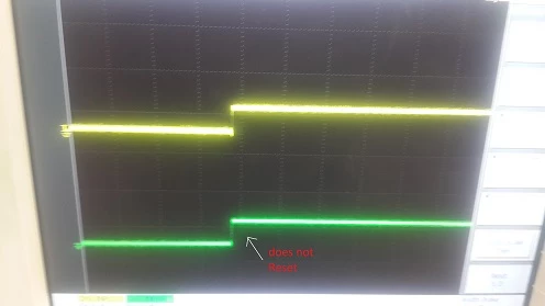

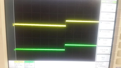

    pkumar1883
    Mar 29, 2016 7:28 AM UTC
    Posted on March 29, 2016 at 09:28
    In above Image I have captured the NRST pin of my both controller. In above image NRST waveform are identical and both controller RESET properly.
    While in image below both waveform are again same and identical but the controller associated with Green waveform does not RESET(no LED glow no buzzer beep).
