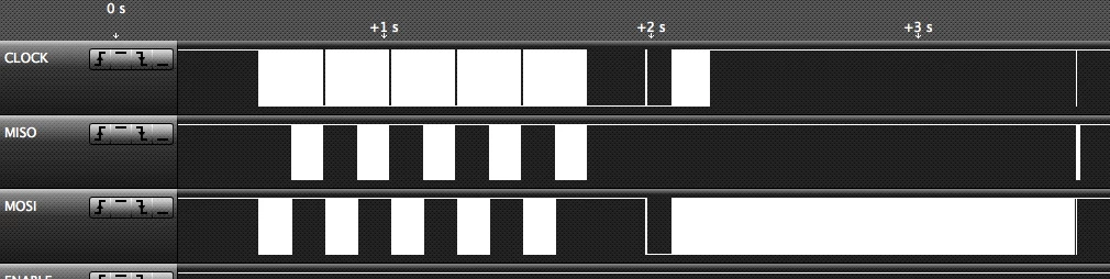

    Starting program.
    I even built a LED Cube yesterday just to have a little success with working with these cute µCs. _That_ works at least ;) I'm still lost. What else could I try? Edit: I just stumbled upon these App notes for STM32F0xx - how to use DMA:http://www.icbase.com/Promotion/download/AN4pdf In that SPI example, they use TIM2 for generating a 4kHz PWM which is used as trigger for DMA. In the examples on the net I saw nothing like this. Is it necessary to use TIM2 to generate somehting like my SPI clock frequency for DMA to start? Or is that just misleading?
    de_koepi
    de_koepiAuthor
    May 9, 2014
    Posted on May 09, 2014 at 19:59
    A little progress - by shifting some lines of code around, the program starts again at least.

    When the waiting-for-SPI-transfer-ready loop is removed, the program runs, even with starting the RAM check completely in DMA. The results are wrong though:
    Starting program.
    RAM chip 0 is not OK! -> [0] 255 [1] 255 [2] 255 [3] 255 [4] 255 [5] 255 [6] 255 [7] 255 [8] 255 [9] 255
    RAM chip 1 is not OK! -> [0] 255 [1] 255 [2] 255 [3] 255 [4] 255 [5] 255 [6] 255 [7] 255 [8] 255 [9] 255
    RAM chip 2 is not OK! -> [0] 255 [1] 255 [2] 255 [3] 255 [4] 255 [5] 255 [6] 255 [7] 255 [8] 255 [9] 255
    RAM chip 3 is not OK! -> [0] 255 [1] 255 [2] 255 [3] 255 [4] 255 [5] 255 [6] 255 [7] 255 [8] 255 [9] 255
    RAM chip 4 is not OK! -> [0] 255 [1] 255 [2] 255 [3] 255 [4] 255 [5] 255 [6] 255 [7] 255 [8] 255 [9] 255
    Reading COM11 again from OV7670: [143] -> Prescaler 16, frequency 500 kHz.
    Select first RAM chip.
    Writing image succeeded! Wrote 614400 bytes, used 5 RAM chips.
    Image dimension: 640 x 480 pixel. 10 bytes captured:
    [101]: 159 [102]: 207 [103]: 162 [104]: 222 [105]: 64 [106]: 221 [107]: 123 [108]: 217 [109]: 72 [110]: 215
    The results at bottom are via SPI polling an correct. Maybe there is some special order I have to adhere to so that the transfers work?

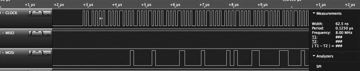

    A little progress as I see _some_ data, but not the proper result yet:
    Starting program.
    RAM chip 0 is not OK! -> [0] 254 [1] 126 [2] 255 [3] 127 [4] 128 [5] 0 [6] 129 [7] 1 [8] 130 [9] 2
    RAM chip 1 is not OK! -> [0] 254 [1] 126 [2] 255 [3] 127 [4] 128 [5] 0 [6] 129 [7] 1 [8] 130 [9] 2
    RAM chip 2 is not OK! -> [0] 254 [1] 126 [2] 255 [3] 127 [4] 128 [5] 0 [6] 129 [7] 1 [8] 130 [9] 2
    RAM chip 3 is not OK! -> [0] 254 [1] 126 [2] 255 [3] 127 [4] 128 [5] 0 [6] 129 [7] 1 [8] 130 [9] 2
    RAM chip 4 is not OK! -> [0] 123 [1] 234 [2] 109 [3] 228 [4] 143 [5] 232 [6] 73 [7] 238 [8] 108 [9] 216
    I changed the DMA-Transfer routine to disable and enable SPI completely:

    Logic Analyzer at 16 MHz ...
    The DMA transfer looks alright, this is 0..1..2..3..4..5... and so on. Zooming into the MISO signal shows that the weird results I am seeing from the code are there on the line as well.
    I tried lowering the SPI frequency. With a Prescaler > 8, MISO stays calm all the time (constantly at HIGH level) until the polling code starts at the end.
    Maybe someone else had such a behaviour and could solve it?
