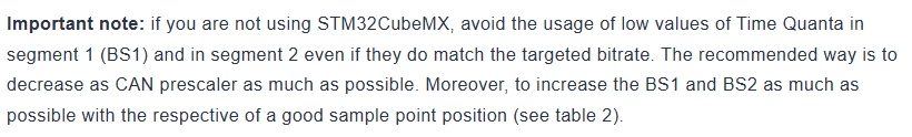

I’m pretty sure it’s the bit timing configuration related issue.
You have this configuration:
  hcan.Init.Prescaler = 9;
hcan.Init.TimeSeg1 = CAN_BS1_2TQ;
hcan.Init.TimeSeg2 = CAN_BS2_1TQ;
Please avoid low BS1 and BS2 values. So increase them while decreasing the CAN prtescaler.
Some users faced the same issue while using a such low values for BS1 and BS2.
So I suggest you to refer to this knowledge base article on how to configure the CAN bit time for STM32:
It already mentioned that note:
Hope that helps you as well as others ..
