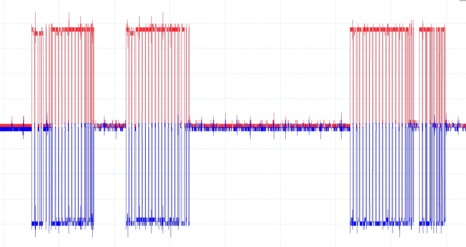

I have a blue pill board connected through PA11 (CAN Rx) and PA12 (CAN Tx) to CJMCU-1051 transceiver ( relation between connection: CRX -> PA11, CTX -> PA12).
The CANL and CANH signals from the transceiver are connected to the CAN bus on which there are already two nodes and they communicate with each other with baudrate = 500kBps (4 frames run on the network):
0693W000005BbAyQAK.pngSo network is working.

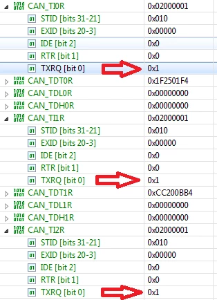

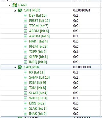

As answer from function
ststus = CAN_Init(CAN1, &CAN_InitStructure);
I got value equal to 1, so CAN protocol is correctly implemented and it is in normal mode. This situation is confirmed by values of registers:
0693W000005BbFAQA0.pngIn main program loop I want to send a frame every 1s, the source_time variable is a variable incremented in the SysTick interrupt and I want to send it by the bus
while (1)
		if(flag_)
			TxMessage.Data[0] = (uint8_t)(source_time >> 24);
			TxMessage.Data[1] = (uint8_t)(source_time >> 16);
			TxMessage.Data[2] = (uint8_t)(source_time >> 8);
			TxMessage.Data[3] = (uint8_t)source_time;
			temp1 = CAN_Transmit(CAN1, &TxMessage);
			temp2 = CAN_GetLastErrorCode(CAN1);
			TransmitStatus[0] = CAN_TransmitStatus(CAN1,0);
			TransmitStatus[1] = CAN_TransmitStatus(CAN1,1);
			TransmitStatus[2] = CAN_TransmitStatus(CAN1,2);
			flag_ = 0;
The result is that transmission status is set to pending (the value is returned by the CAN_TransmitStatus function) for all FIFO banks, what is confirmed by registers:

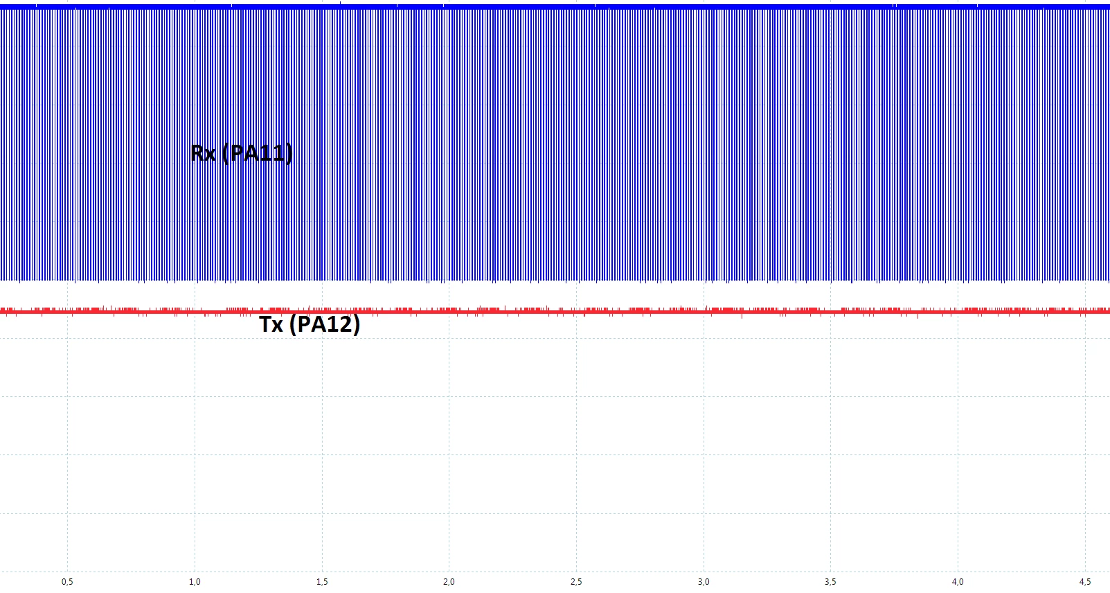

After connection oscilloscope between microcontroller and transceiver I can notice that transceiver allow for transferring CRX frames (PA11 pin), o that I conclude that transceiver works properly:
Summing up, maybe someone has an idea why STM does not send a frame to the transceiver but is in pending mode all the time?
