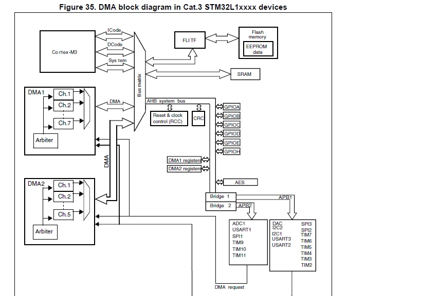

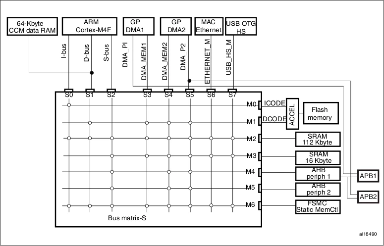

Hi everyone! new around here.. i am taking an online course about DMA controller.
At the very first lesson they teach how to check routing using DMA BUS MATRIX.
The problem is that i cannot find of any of my two board that uses STM32L100 or STM32F103.
Am i missing something or looking wrong on the documentation? (RM and Datasheet)
Thanks in advance!
