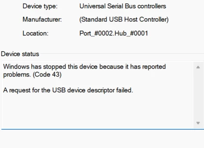

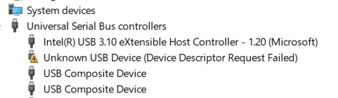

Explorer
April 26, 2025
My newer version Bluepill (the one with USB-C connector) displayed as "Unknow USB Device" Under Windows 10 Device Managers, instead of as USB DFU Device", when boot0=high, boot1=low. Any comments?
Tesla DeLorean
Guru
April 27, 2025
It's possible that this isn't an authentic STM32F1 part. STMicro isn't going to support counterfeit devices.
Have you loaded/installed STM32 Cube Programmer? That might pull drivers or .INF for the VID/PID of the USB device.
What does Device Manager report as the VID/PID of this Unknown Device?
Explorer
April 27, 2025

Explorer
April 27, 2025
It seems VID/PID is NOT right. But the preloaded blinking program works and the LED on GPIO PC13 is blinking. 8MHz external clock is verified on scope. what will be the remedy?
Tesla DeLorean
Guru
April 27, 2025
Have you considered a NUCLEO board?
With the BOOT pin you're trying to invoke the System Loader in ROM, not the FLASH code that the vendor put on the MCU
Double check your cable is good, a data cable, not a charging cable. Plug in the cable whilst the BOOT button is pressed.
It could be the device is counterfeit .. check for support directly from the vendor of the board.
