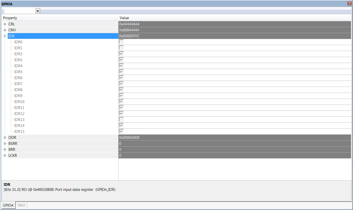

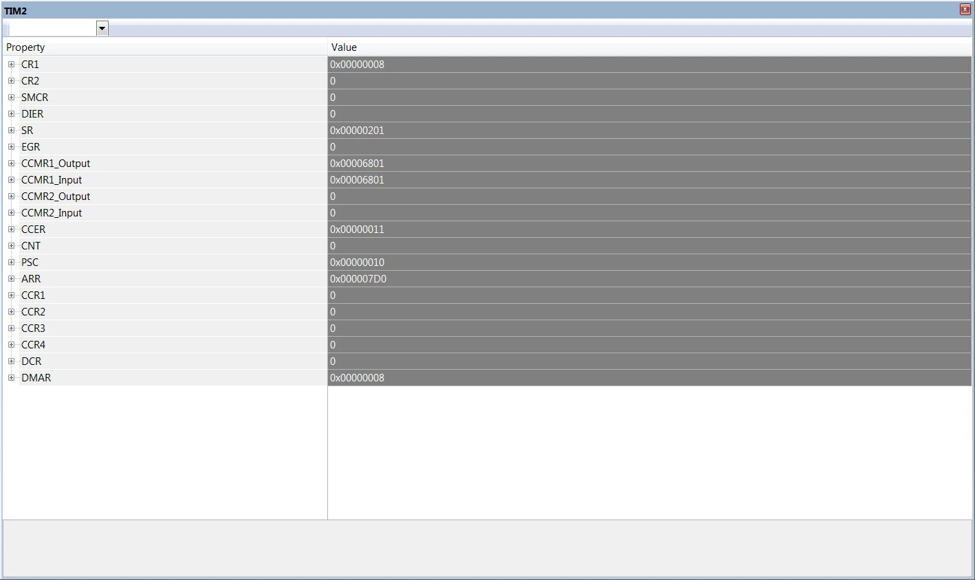

    waclawek.jan
    January 30, 2018
    Posted on January 30, 2018 at 16:18
    Read out and check/post the content of relevant GPIO and TIM registers.
    Darrin Weiss
    January 30, 2018
    Posted on January 30, 2018 at 16:34
    waclawek.jan
    January 30, 2018
    Posted on January 30, 2018 at 17:17
    In timer, you want to have SMCR.TS set to TI1FP1 and SMCR.SMS set to Trigger Mode - thus pressing the blue button starts the timer. You also want to have a nonzero CCR2 otherwise your output pulse length is zero.
    You can try to set all this in the debugger, you don't need to write any code to try.
    I don't Cube so I don't know how to click this in CubeMX nor write in Cube's terms.
    I did not check GPIO - sorry, I don't use 'F1xx and their GPIO is different from the others.

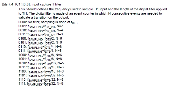

    If you are using a mechanical switch,
    apply the Trigger Filter = 15 (most filtering or debounce)
    filter is the number of trigger samples the trigger signal has be stable before the input signal to the timer changes.
    see RM;

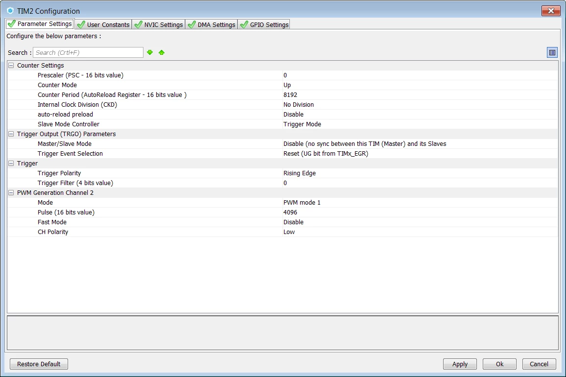

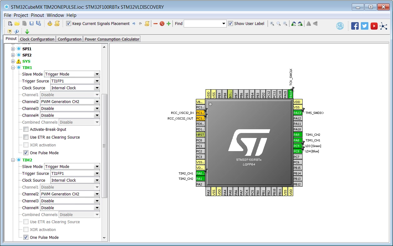

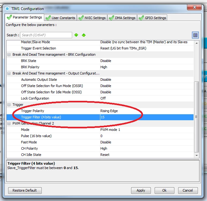

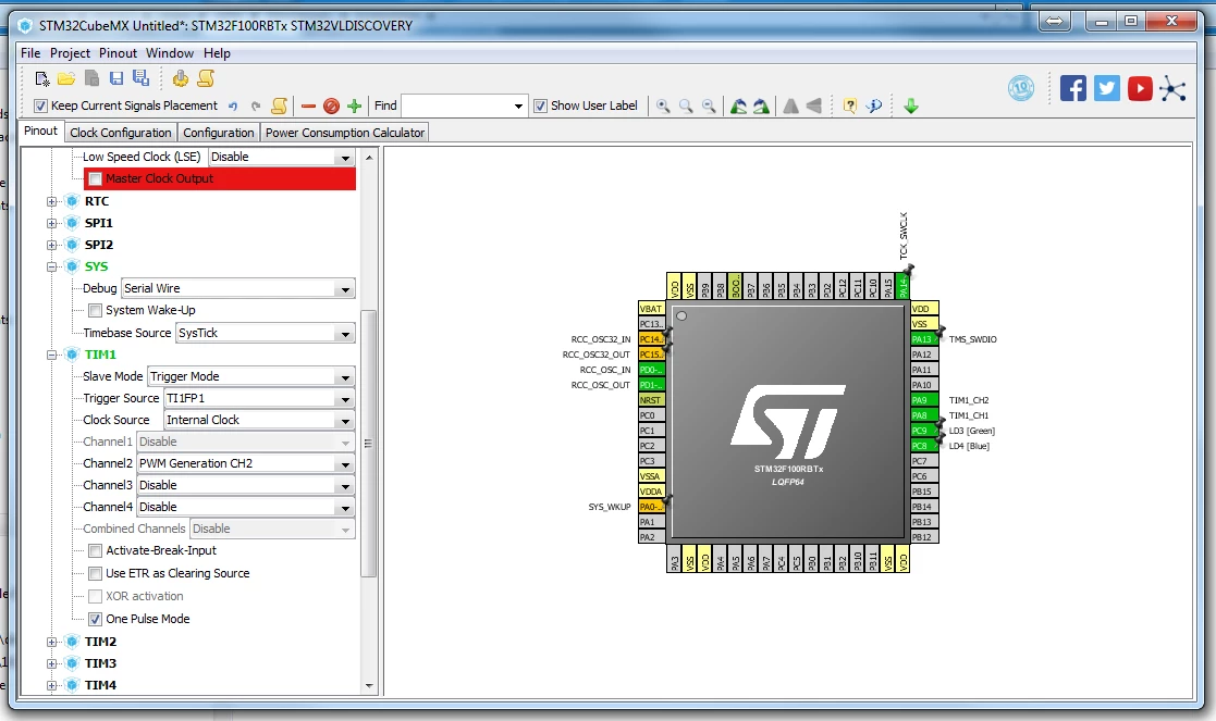

    Darrin Weiss
    February 5, 2018
    Posted on February 06, 2018 at 00:22
    Thanks everyone.  Most things are easy, once you know the answer
    Below is the STM32CubeMX config (for 2 timers, I got bold), and the info for Timer 2.  The timers should be started with this code:
    HAL_TIM_OnePulse_Start(&htim1, TIM_CHANNEL_1);
    HAL_TIM_OnePulse_Start(&htim2, TIM_CHANNEL_2);
    I would now like to start Timer 2 from Timer 1 being started instead of the button (I have wired the button to Timer 1 as well).  Working to try to figure out that next.
    waclawek.jan
    February 6, 2018
    Posted on February 06, 2018 at 09:31
    In TIM1 once set to trigger from the input (button), set TIM1_CR2.MMS to 0b001, so that enable signal is used as TRGO.
    In TIM2, set TIM2_SMCR.TS to that Internal Trigger which is coming from TIM1, see TIM2 row of table at TIMx_SMCR description in RM. Then set TIM2_SMCR.SMS to 0b110 for Trigger mode.
    That's all.
