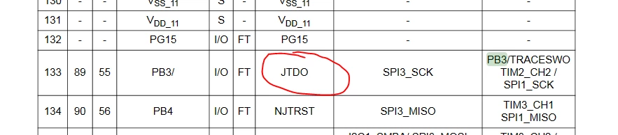

Hi All.
On my latest project I am using STM32F100VCT6 and PB3.  I am using this Pin as a quadrature encoder input for Timer 2 combined with PA15.  I can not get the encoder to work.  I tried setting PB3 up as an interrupt and it does not work, but PA15 does, I then tried setting PB3 as a GPIO and it does not work and PA15 does?????  I thought the CPU was faulty so swapped it and still noting from PB3.  The input signal is 5V peak to peak, but the datasheet states that pin is 5 Volt tolerant .
I have produced more than 20 designs using various STM32 processors never had this problem before.

    Hello
    the default state of PB3  after reset is as JTDO.
    So you need to remap it to PB3

    Posted on August 11, 2017 at 14:45
    Enable the AFIO clock, and then free up the debugger pins
    RCC_APB2PeriphClockCmd(RCC_APB2Periph_AFIO, ENABLE);
    GPIO_PinRemapConfig(GPIO_Remap_SWJ_Disable, ENABLE);
    or
    GPIO_PinRemapConfig(GPIO_Remap_SWJ_JTAGDisable, ENABLE);
    https://community.st.com/0D70X000006SyA1SAK
    The HAL has something similar
    __HAL_AFIO_REMAP_SWJ_NOJTAG

    Hi All,
    Huge thanks for the responses, very helpful.
    I used the Cube to configure the 'PINS'.  SYS is set to 'NO DEBUG' so I assumed it would handle things like setting the functions to alternatives and disabling the JTAG.
    I think this should be included in the cube or a commented warning that it needs to be handled inserted in the USER SysInit section.  It would have saved me an others a few days scratching our heads.
    In the end I disabled SW and JTAG (*WARNING*) only do this if you have reset brought out to your programming header.
    SET_BIT(AFIO->MAPR, AFIO_MAPR_SWJ_CFG_DISABLE);
    Now PB3 is now working thank you very much....
