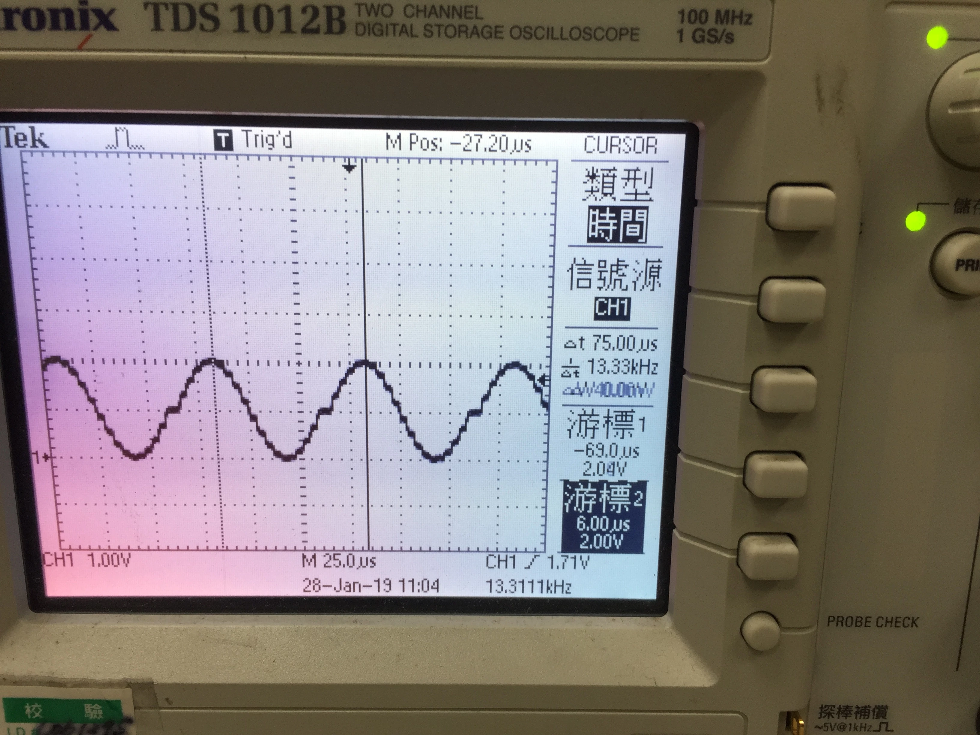

STM32F100C8T6 can't generate sinewave of correct frequency
The chip I am using is STM32F100C8T6.
I want to generate a sine wave with 40Khz between 0 to 2V ,but I cant't get correct frequency.
I have finished reading STM32F100 datasheet (RM0041) and AN3126,AN4566. After that,I am writing a program based on the files. what mistake did i make?

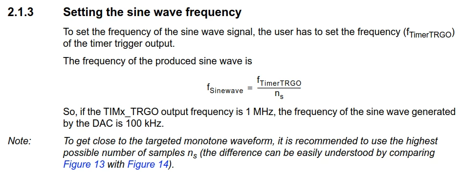

1.​AN3126 sinewave equation:
fsineware = 40Khz ,ns=20 ftimertrgo = 40K*20 =800Khz
2. ftimertrgo equation:
Ttimertrgo= (1/ftimertrgo) = (TIM_Period+1)*(TIM_Prescaler+1)/TIMxCLK
TIMxCLK =24Mhz, Set TIM_Period=9, get TIM_Prescaler=2:

    Jan 28, 2019 2:43 AM UTC
    Don't wait for HSE startup when using HSI. HSI clock should already be running.​

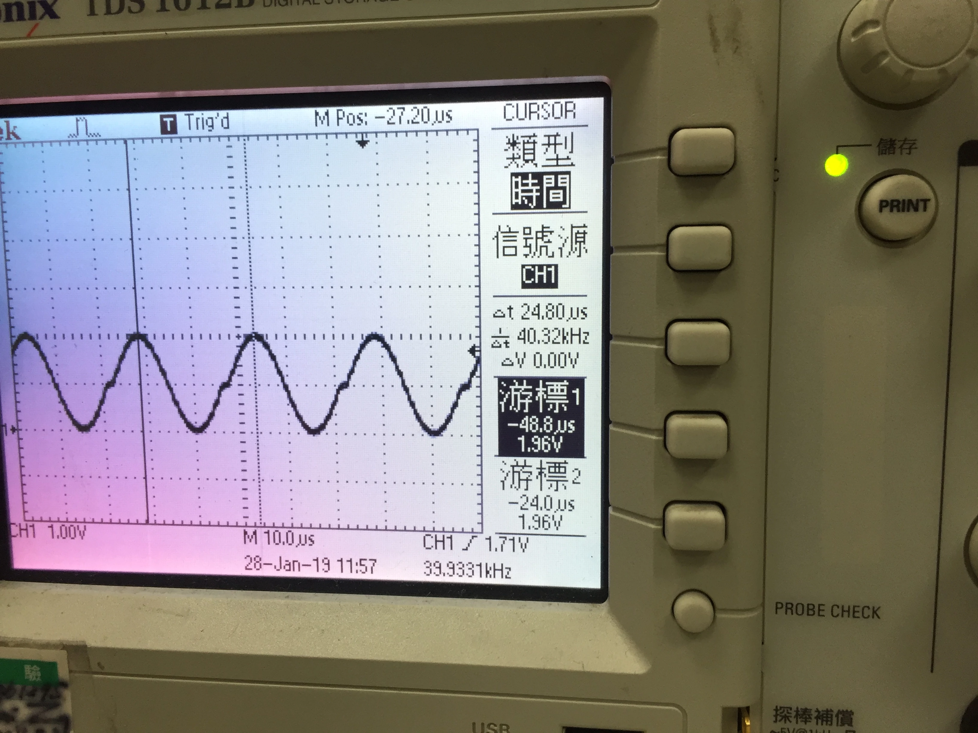

    cTomm
    cTommAuthor
    Jan 28, 2019 3:27 AM UTC
    Thanks, I get it . Thanks for your help, you do gave me a big favor.
    fix code:
