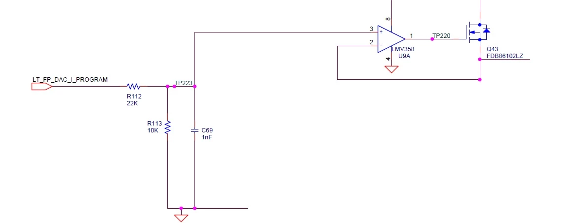

Hi guys,
I´m having some difficulties getting the DAC working properly with the STM32F100 LQFP48pins.
First of all, Reference Manual says the following
On 64-pin packages and packages with less pins
The VREF+ and VREF- pins are not available, they are internally connected to the ADC
voltage supply (VDDA) and ground (VSSA).
I´ve in my PCB VDDA connected to 3,3v.
11.3.5 DAC output voltage
Digital inputs are converted to output voltages on a linear conversion between 0 and VREF+.
The analog output voltages on each DAC channel pin are determined by the following
equation:
DACoutput=VREF*DOR/4095
Mi code is the following;
    GPIO_InitStruct.GPIO_Pin   = GPIO_Pin_4;
    //GPIO_InitStruct.GPIO_Speed = GPIO_Speed_50MHz;
    GPIO_InitStruct.GPIO_Mode  = GPIO_Mode_AIN;
    GPIO_Init(GPIOA_BASE, &GPIO_InitStruct);
    // DAC channel1 Configuration
    DAC_StructInit(&DAC_InitStruct);
    DAC_InitStruct.DAC_Trigger = DAC_Trigger_None;
    DAC_InitStruct.DAC_WaveGeneration = DAC_WaveGeneration_None;
    DAC_InitStruct.DAC_OutputBuffer = DAC_OutputBuffer_Disable;
DAC_Init(xDACTable[DAC1].eDAC_Channel, &DAC_InitStruct);
DAC_Cmd(DAC_Channel_1, ENABLE);
DAC_SetChannel1Data(DAC_Align_12b_R, 0x0FFF);
DAC_SoftwareTriggerCmd(DAC_Channel_1, ENABLE);
Loading in DAC DOR register the Value =4095 I only get 2,5v instead of 3,3v
Anyone knows why am I doing wrong?

    Tesla DeLorean
    Guru
    October 27, 2014
    Posted on October 27, 2014 at 19:27
    Loading the pin too heavily?
    gerardo
    gerardoAuthor
    October 28, 2014
    Posted on October 28, 2014 at 15:37
    If I Remove R112 and I get the measurement of DAC output I get the desired 3,3v.
    If I relocate R112 and removing R113 then i get 3,3v. Then If I relocate R113 again I get 2,5v.
    Is correct the definition of  GPIO_InitStruct.GPIO_Mode  = GPIO_Mode_AIN; for a DAC Output??
    Tesla DeLorean
    Guru
    October 28, 2014
    Posted on October 28, 2014 at 15:58
    Yes, it disables all the digital logic on the pin including the schmitt trigger input.
    Might consider
    DAC_InitStructure.DAC_OutputBuffer = DAC_OutputBuffer_Enable;
    gerardo
    gerardoAuthor
    October 28, 2014
    Posted on October 28, 2014 at 16:10
    What does it mean?
    11.3.2 DAC output buffer enable
    The DAC integrates two output buffers that can be used to reduce the output impedance,
    and to drive external loads directly without having to add an external operational amplifier.
    frankmeyer9
    October 28, 2014
    Posted on October 28, 2014 at 16:13
    Might consider
    Correct.
    I'm repeating myself here, but sometimes when writing software, one needs to take the corresponding hardware into consideration.
    Take a look at the datasheet. The load resistance presented to the DAC output in your circuit is almost two orders of magnitude too small for unbuffered mode (1MOhm vs. 32kOhm, ignoring opamp input and C leakage).
