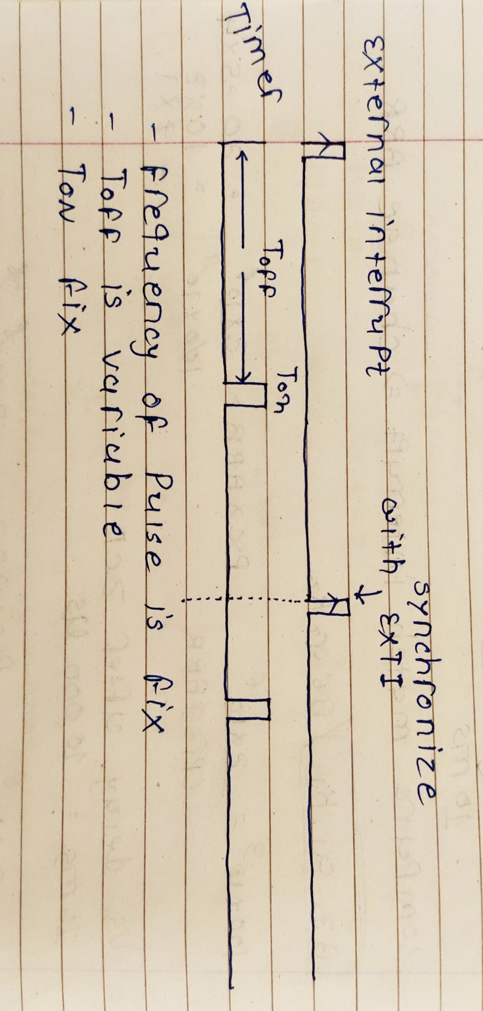

waclawek.jan
Mar 6, 2020 8:56 AM UTC
I don't quite understand, please draw a timing diagram.
parth kothiya
Mar 9, 2020 1:06 PM UTC
berendi
berendiBest answer
Principal
Mar 9, 2020 2:16 PM UTC
It is an external signal, isn't it?
EXTI interrupts are not really useful for synchronization, because interrupt latency is variable, maybe between 10-40 cycles, depending on the timing w.r.t. other interrupts in the system.
Exact synchronization down to a system clock cycle can be achieved by using a timer trigger input, which can be the timer CH1, CH2, or ETR pin.
I've changed the above code a bit, using the timer in downcounting mode, so that the compare register can be set to a fixed value, which is the number of cycles before the downcounter reaches 0, to start the pulse. The reload (ARR) value should be the sum of Toff and Ton, minus the adjustment required because of the 2 cycles trigger latency. It can be changed anytime, when the new Toff value becomes available.
TIM3->ARR = 0xFFFF; // set it to Toff + Ton - 3, as the trigger takes 2 cycles to have an effect
TIM3->SMCR =
 TIM_SMCR_TS_2|TIM_SMCR_TS_1|TIM_SMCR_TS_0| // TS=111: External Trigger input (ETRF)
 TIM_SMCR_SMS_2|TIM_SMCR_SMS_1; // SMS=110: Trigger Mode - The counter starts at a rising edge of the trigger TRGI
TIM3->CCR3 = 360 - 1; // start the pulse 360 cycles ( = 10 μs ) before the counter reaches 0
TIM3->CCMR2 |=
 TIM_CCMR2_OC3M_2|TIM_CCMR2_OC3M_1; // 110: PWM mode 1
TIM3->CCER |= TIM_CCER_CC3E; // Enable PWM output on channel 3
TIM3->CR1 |= TIM_CR1_OPM | TIM_CR1_DIR; // enable one pulse mode, downcounting
