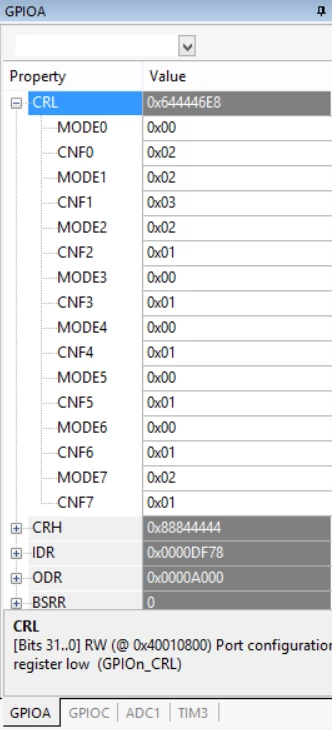

A piece of code from STM32CubeMX v4.0 and latest F1 drivers generated for STM32VLDiscovery (the button is pulled-down by external resistor):
LL_GPIO_InitTypeDef GPIO_InitStruct;
/* GPIO Ports Clock Enable */
LL_APB2_GRP1_EnableClock(LL_APB2_GRP1_PERIPH_GPIOC);
LL_APB2_GRP1_EnableClock(LL_APB2_GRP1_PERIPH_GPIOD);
LL_APB2_GRP1_EnableClock(LL_APB2_GRP1_PERIPH_GPIOA);
GPIO_InitStruct.Pin = LL_GPIO_PIN_0;
GPIO_InitStruct.Mode = LL_GPIO_MODE_FLOATING;
LL_GPIO_Init(GPIOA, &GPIO_InitStruct);
and the results from the Keil debugger:
So commented the line below to prove that there is only one line of code used for GPIOA initialization:
// LL_GPIO_Init(GPIOA, &GPIO_InitStruct);
and got as expected (the default settings for GPIOA)
It seems that the LL_GPIO_Init gives messy config on more than one pin. Am I wrong?

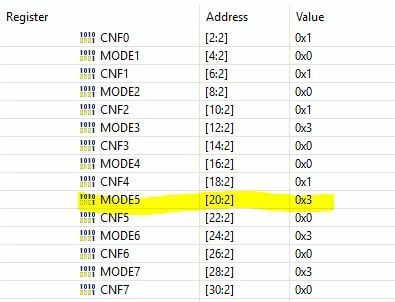

    I think I have found something similar. When I do this:
      GPIO_InitStruct.Pin = LL_GPIO_PIN_4|LL_GPIO_PIN_5;
      GPIO_InitStruct.Pin = LL_GPIO_PIN_3|LL_GPIO_PIN_6|LL_GPIO_PIN_7;
      GPIO_InitStruct.Mode = LL_GPIO_MODE_OUTPUT;
      GPIO_InitStruct.Speed = LL_GPIO_SPEED_FREQ_HIGH;
      GPIO_InitStruct.OutputType = LL_GPIO_OUTPUT_PUSHPULL;
    the result looks like this:
    The second LL_GPIO_Init reconfigures GPIO_PIN_5 from an input to an output!
    (I am using the stm32f1xx_ll_gpio.c suggested by Imen D as answer to your ''led blinking fails'' question.)

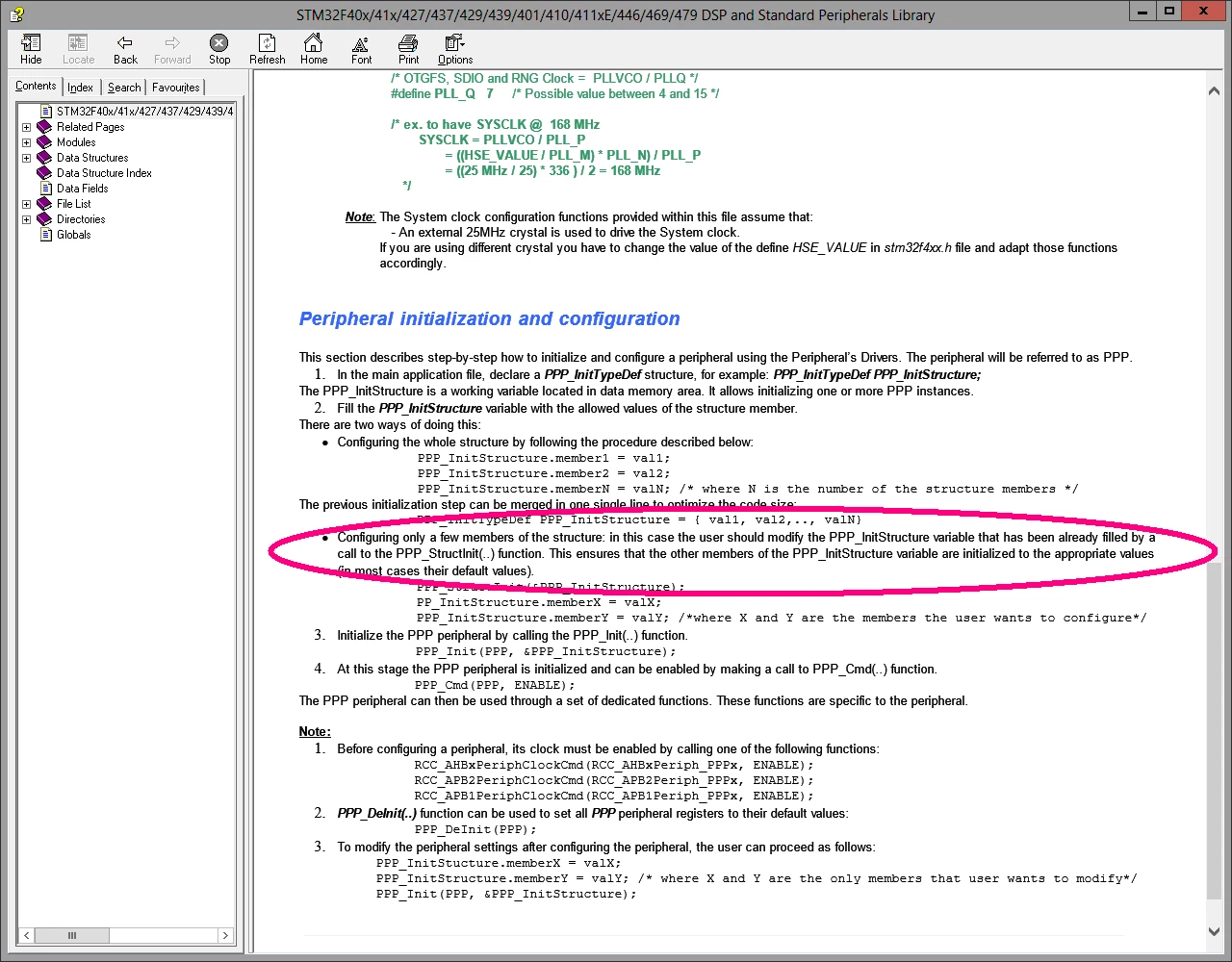

    Isn't this the same issue all over again, with not having initialized the whole structure used for the 'library' call?

    You're contradicting yourself within two consecutive lines:
    unfortunately in this case, rather than making SPL great again,
    that's the risk with any library.
    So what's that great about SPL, exactly?
    PS. To be fair, SPL *did* come with *some* documentation which *did* contain a guideline about initializing the init structs - whereas Cube contains only the doxygen autovomit. But then nobody read the documentation back then, too, and this problem was a regular here. It sort of went away with most people relying on CubeMX generating their init stuff, which may be correct - I don't know, I can't run CubeMX as I refuse install Java and ST refuses to attach the JVM to their javoids.
