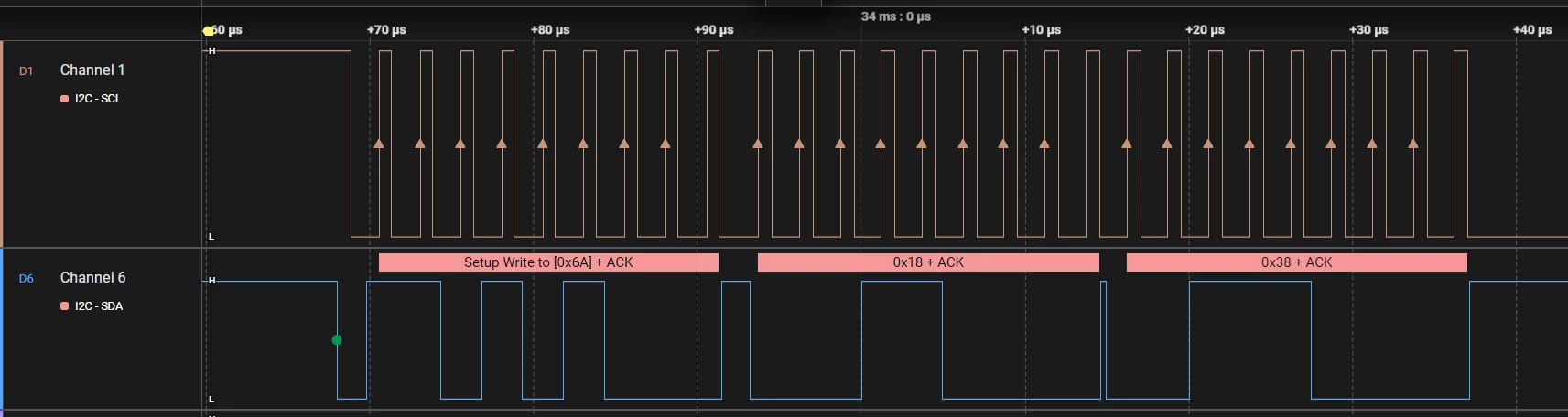

 Here is a LA shot of the transaction:
As you can see, the SCL line is left high, and the transaction thus does not terminate properly. I should note that the data is received without issue.

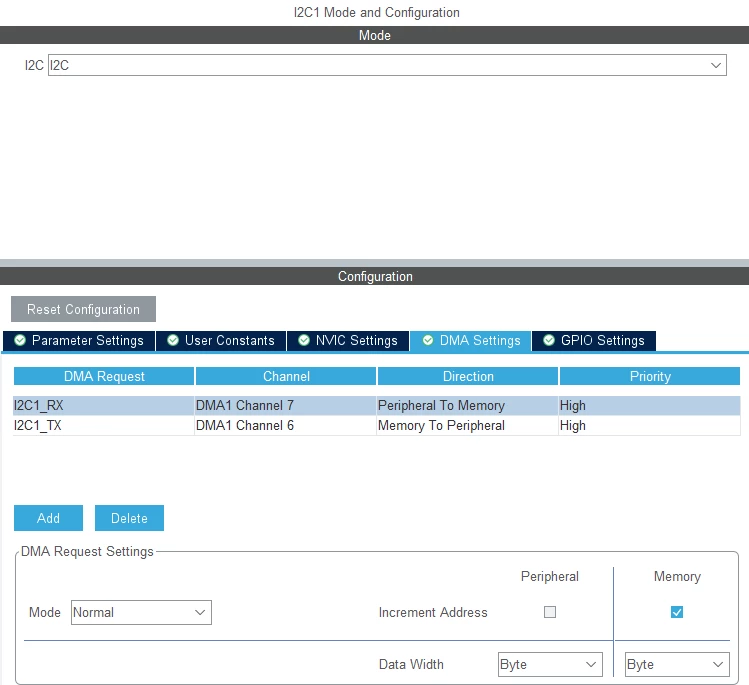

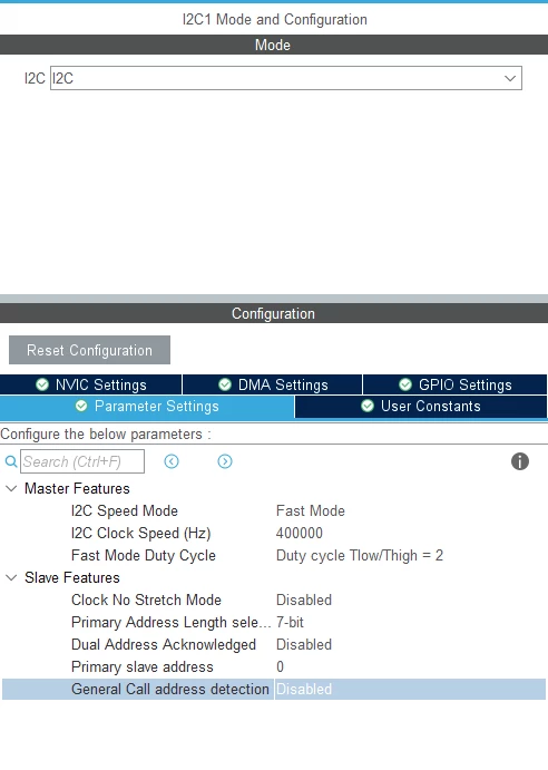

Below is my cube configuration:
