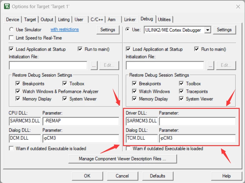

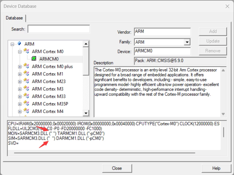

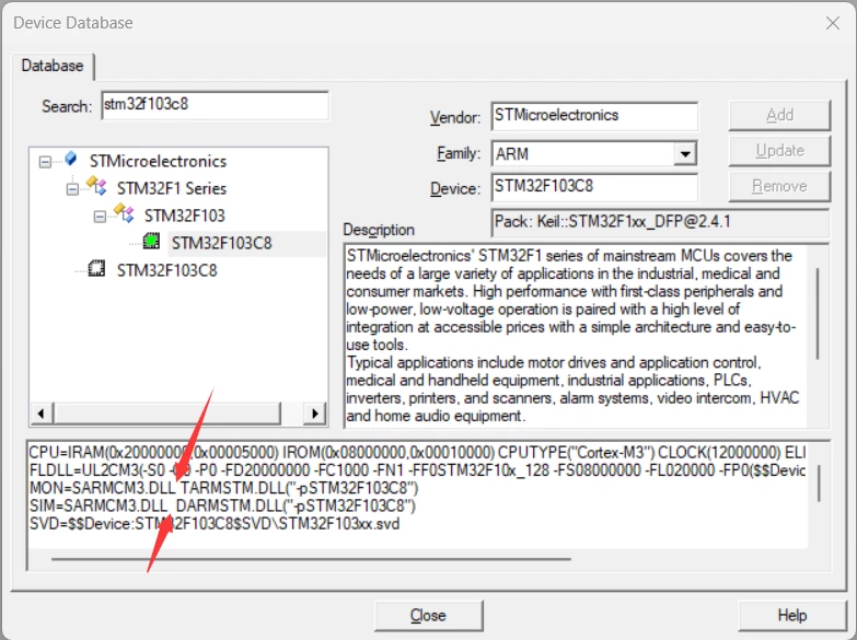

STM32F1 DFP problem
Keil MDK Device Database
If no parameter, it needs to look like this
So, MDK can not setting "Option for target-debug" correctly
KDJEM.1
KDJEM.1Best answer

Hello @Shiina ,
Could you please explain what is the impact of this parameter on compilation?
Note that STM32F1xx_DFP package is provided by ARM.
Thank you.
Kaouthar
