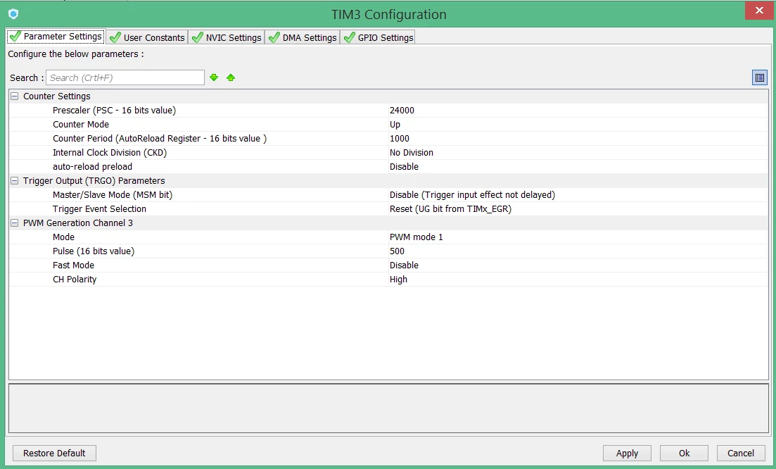

Today's F1 v1.6.1 HAL driver pack fixed all issues I had with GPIO so decided to move forward with TIM3 and LL.
The goal: use TIM3/PWM to blink the BLUE LED (PC8) - STM32VLDiscovery.
CubeMX generated code:
/* TIM3 init function */
static void MX_TIM3_Init(void)
  LL_TIM_InitTypeDef TIM_InitStruct;
  LL_TIM_OC_InitTypeDef TIM_OC_InitStruct;
  LL_GPIO_InitTypeDef GPIO_InitStruct;
  /* Peripheral clock enable */
  LL_APB1_GRP1_EnableClock(LL_APB1_GRP1_PERIPH_TIM3);
  TIM_InitStruct.Prescaler = 24000;
  TIM_InitStruct.CounterMode = LL_TIM_COUNTERMODE_UP;
  TIM_InitStruct.Autoreload = 1000;
  TIM_InitStruct.ClockDivision = LL_TIM_CLOCKDIVISION_DIV1;
  LL_TIM_Init(TIM3, &TIM_InitStruct);
  LL_TIM_DisableARRPreload(TIM3);
  LL_TIM_SetClockSource(TIM3, LL_TIM_CLOCKSOURCE_INTERNAL);
  LL_TIM_OC_EnablePreload(TIM3, LL_TIM_CHANNEL_CH3);
  TIM_OC_InitStruct.OCMode = LL_TIM_OCMODE_PWM1;
  TIM_OC_InitStruct.OCState = LL_TIM_OCSTATE_DISABLE;
  TIM_OC_InitStruct.OCNState = LL_TIM_OCSTATE_DISABLE;
  TIM_OC_InitStruct.CompareValue = 500;
  TIM_OC_InitStruct.OCPolarity = LL_TIM_OCPOLARITY_HIGH;
  LL_TIM_OC_Init(TIM3, LL_TIM_CHANNEL_CH3, &TIM_OC_InitStruct);
  LL_TIM_OC_DisableFast(TIM3, LL_TIM_CHANNEL_CH3);
  LL_TIM_SetTriggerOutput(TIM3, LL_TIM_TRGO_RESET);
  LL_TIM_DisableMasterSlaveMode(TIM3);
  /**TIM3 GPIO Configuration
  PC8   ------> TIM3_CH3
  GPIO_InitStruct.Pin = LED_BLUE_Pin;
  GPIO_InitStruct.Mode = LL_GPIO_MODE_ALTERNATE;
  GPIO_InitStruct.Speed = LL_GPIO_SPEED_FREQ_LOW;
  GPIO_InitStruct.OutputType = LL_GPIO_OUTPUT_PUSHPULL;
  LL_GPIO_Init(LED_BLUE_GPIO_Port, &GPIO_InitStruct);
  LL_GPIO_AF_EnableRemap_TIM3();
And the main() part:
  MX_GPIO_Init();
  MX_TIM3_Init();
  /* USER CODE BEGIN 2 */
I added: ''LL_TIM_EnableCounter(TIM3);'' but the LED was still off. Started the debugger and noticed that the CCER register is cleared so I enabled CC3E manually and the LED started blinking.
Tried the ''LL_TIM_OC_ConfigOutput(TIM3, LL_TIM_CHANNEL_CH3, LL_TIM_OCPOLARITY_HIGH|xx);'' but failed.
Finally I fixed the issue using CCER register and it of course works.
    TIM3->CCER=0x00000100;                    // Capture Compare Output Enable  - channel3
If you could share your experience and help me setup the TIM3 for PWM job using LL drivers.
I do not have LL drivers 'how to guide' so it is easier for me to play at the register level than investigate why LL drivers behavies different way than I expect.
I'd be grateful if  someone from ST could share the LL manual - how the drivers are supposed to be used.
Thanks in advance,
Bogdan

    The library appears to do exactly what you commanded it to do:
    thus, it did not enable that channel.
    Or, use LL_TIM_CC_EnableChannel().
    (Yes, I wouldn't touch Cube with a stick, LL or HAL. This was 5 minutes of browsing F4Cube sources; but I believe 'F1 will be the same).
