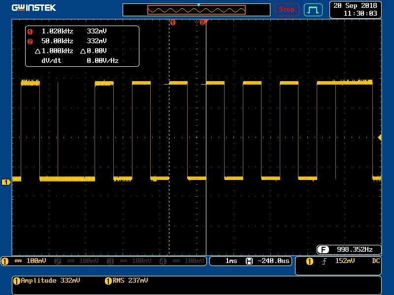

I am using a STM32F072 microcontroller with a matrix keypad.
The matrix pins are essentially bit banged, using ODR mask commands.
When I set up a timer(doesn't matter which one) and I use the timers interrupt (update and a single capture compare) to toggle a pin (manually) it seems to be late processing some of the capture compare and update interrupts.
This results in a waveform that looks like this:
Even weirder it doesn't appear to have anything to-do with the speed of the interrupt, as I get the same result at 100KHz as I do 1KHz (as seen above).

The glitch only happens when the keypad is enabled.
The keypad only does GPIO pin reads, sets and clears,
The keypad sampling is constantly called from the main loop, not an interrupt so I don't think priority has anything to do with this issue. It doesn't disable interrupts or anything like that.
I don't see reducing the keypad sample speed as a real solution as I suspect that would only make the problem less frequent.
I have now confirmed this, the issue is the same, just much less frequent, it needs to go away entirely.

SOLUTION:
An AND/OR operation on the ODR register ultimately ends up being three instructions, a read, a modify and then a write.
This evaluates to multiple instructions.
When an interrupt is called and another pin is set which is on the port the copied value from the first operation is made redundant as the registers value is changed. This means after the interrupt returns the change from within the interrupt is undone by the assignment of the modified copy of the port.
Example:
In main loop:
PORTA &= MASK1
In interrupt:
PORTA &= MASK2
This compiles to something like:
In main loop:
COPY1 = PORTA;
COPY1 = COPY1 & MASK1; //KEY POINT 1
PORTA = COPY1;
In Interrupt:
COPY2 = PORTA;
COPY2 = COPY2 & MASK1;
PORTA = COPY2;
If an interrupt occurs at KEY POINT 1 then on a single core the instructions look like this:
COPY1 = PORTA;
COPY1 = COPY1 & MASK1; //Enter interrupt after here
COPY2 = PORTA;
PORTA = COPY2; //Return from interrupt after here
PORTA = COPY1;
Note that PORTA is immediately reassigned to the value of COPY1 when the interrupt returns. This is what the issue was here.

What I cannot understand is why the matrix keypad being active makes such a difference. It only performs operations on the ODR. I could try the BSRR and BRR but I don't understand why ODR is at all interfering.
WEIRD SOLUTION?
Changing the GPIO pin set and clear commands to use BSRR and BRR fixed the issue WHY?:\
This answer hints at why, still puzzled:
https://electronics.stackexchange.com/questions/99095/stm32f0-gpiox-odr-vs-gpiox-bsrr

waclawek.jan
Sep 20, 2018 8:48 AM UTC
This is why the GPIO on STM32 have the BSRR register.
