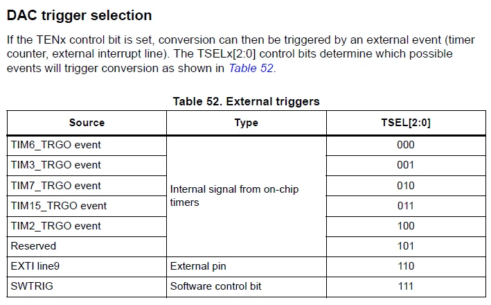

STM32F0x2 RM file DAC trigger source makes confused
Can TIM7 set as trigger source?​
waclawek.jan
waclawek.janBest answer
Dec 19, 2018 2:04 PM UTC
I would say, yes, you can, in models which have TIM7.
The smaller models' don't have TIM7 -  TIM7 is available only on STM32F07x and STM32F09x devices. The 'F051 was the first 'F0x IIRC, and the figure might have originated there.

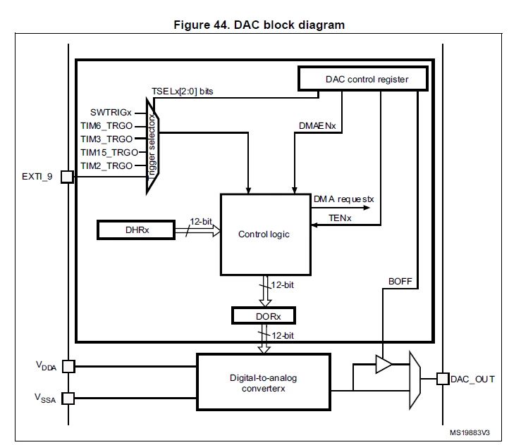

Microstar
MicrostarAuthor
Dec 19, 2018 12:40 PM UTC
DAC block diagram doesn't list TIM7.​
Tesla DeLorean
Guru
Dec 19, 2018 2:40 PM UTC
And how hard is it to actually try and test?
I'd also expect the library code to expose the list it can manage.

@Imen DAHMEN​  @Khouloud GARSI​ Inconsistent block diagram, from F051/F058 parts
Microstar
MicrostarAuthor
Dec 20, 2018 12:54 AM UTC
Yes, library has shown the list.
Maybe I should help making the docs correct.

Dec 19, 2018 3:34 PM UTC
Hello All,
In fact you are correct, the whole TIM7 is not present in the other series (not only the connection).
I raised this internally to the appropriate team for improvement.
Thank you for your help.
