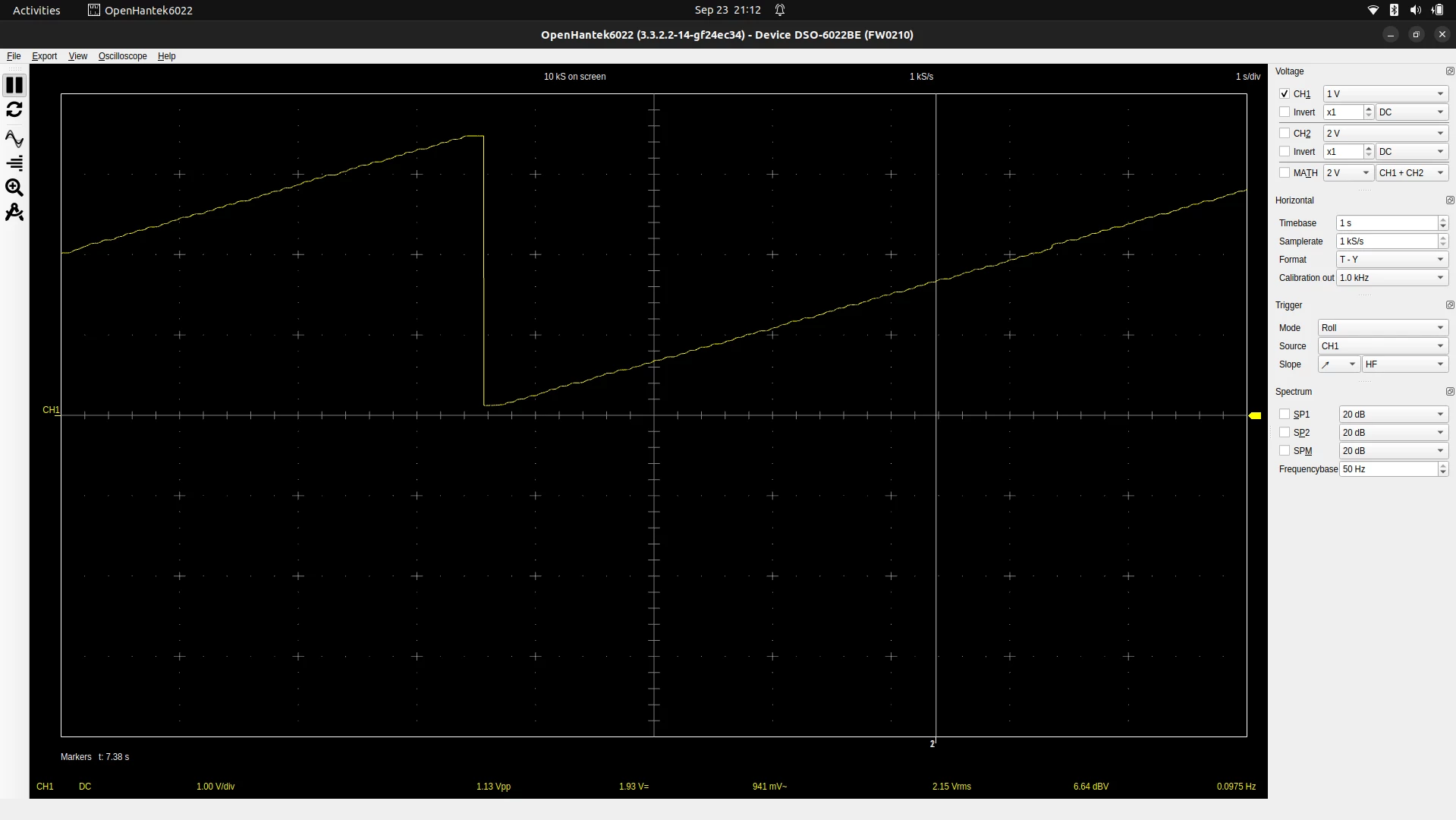

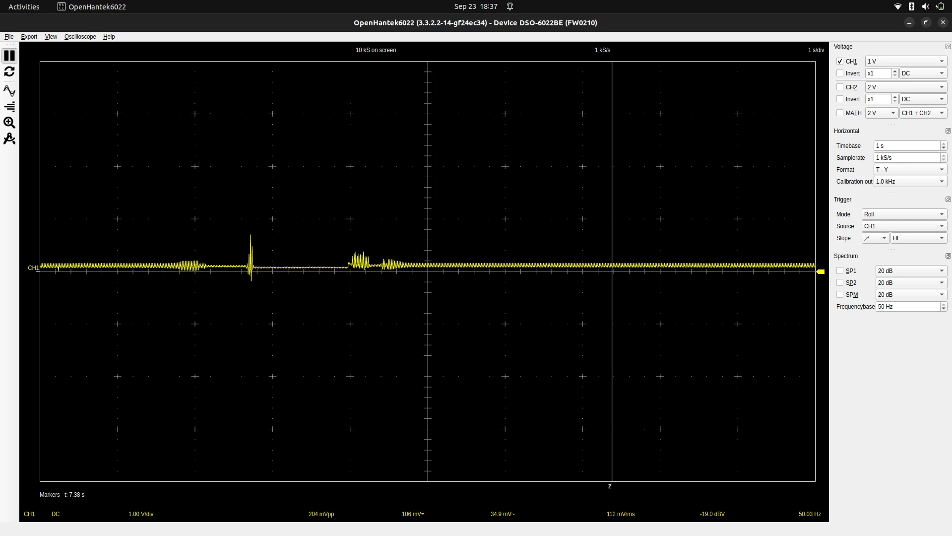

I have been following mastering stm32 book for a while now and checking out the tutorials from the st channel.
I was following the dac tutorial and I had a problem with outputting analog signals in pin A4.
I use eclipse IDE and i am imporing cube-mx files to the default stm project created in eclipse with a tool called CubeMXImporter.
So far, i didn't have any problem with the tool so I really don't know the reason.
my main.c file and hal_msp file is attached below if you would like to take a look.

 HAL_DAC_Init(&hdac);
 HAL_DAC_Start(&hdac, DAC_CHANNEL_2);
 /* USER CODE END 2 */
 volatile uint32_t *GPIOC_MODER = 0x00, *GPIOC_ODR = 0x00;
 volatile uint32_t *GPIOB_MODER = 0X00, *GPIOB_ODR = 0x00;
 GPIOC_MODER = (uint32_t*)0x48000800; // address of the GPIOC MOder register
 GPIOC_ODR = (uint32_t*)(0x48000800 + 0x14); // address of the GPIOc->odr register
 GPIOB_MODER = (uint32_t*)0x48000400;
 GPIOB_ODR = (uint32_t*)(0x48000400 + 0x14);
 //__HAL_RCC_GPIOC_CLK_ENABLE();
 __HAL_RCC_GPIOB_CLK_ENABLE();
 *GPIOC_MODER = *GPIOC_MODER | 0x00000040; // setting c3 as output
 *GPIOB_MODER = *GPIOB_MODER | 0x00004000;
 *GPIOC_ODR = *GPIOC_ODR | 0x08;
 while (1)
	 HAL_DAC_SetValue(&hdac, DAC_CHANNEL_2, DAC_ALIGN_12B_R, dac_value);

Well, turns out that PA5 is actually connected to PD13 and the signal is outputted in that pin. But I really don't know why PA5 pin doesn't show it up.
3 replies

Hello, thanks for the help really, i really don't know the reason, but PA2 pin show the output in DAC and not PA5 , I really don't know why.
roboticsdevAuthorBest answer
September 23, 2023
