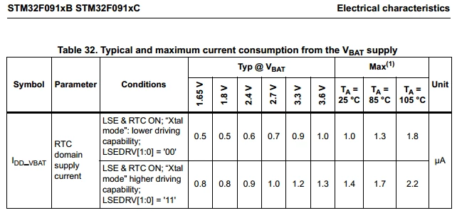

By the way, check the following values from datasheet
1 To exclude custom board hardware issue, I would first use a nucelo board, disconnect VBat and VCC, and perform the current measurement.
2 If Nucleo board works fine, I would check on the custom board:
    VBAT and VCC(and some other power pin) isolation,
    VBAT to Gnd impedance, and
    LSE circuitry.
VBT draws current only when VCC is not present, and it powers RTC, oscillator and backup register only.

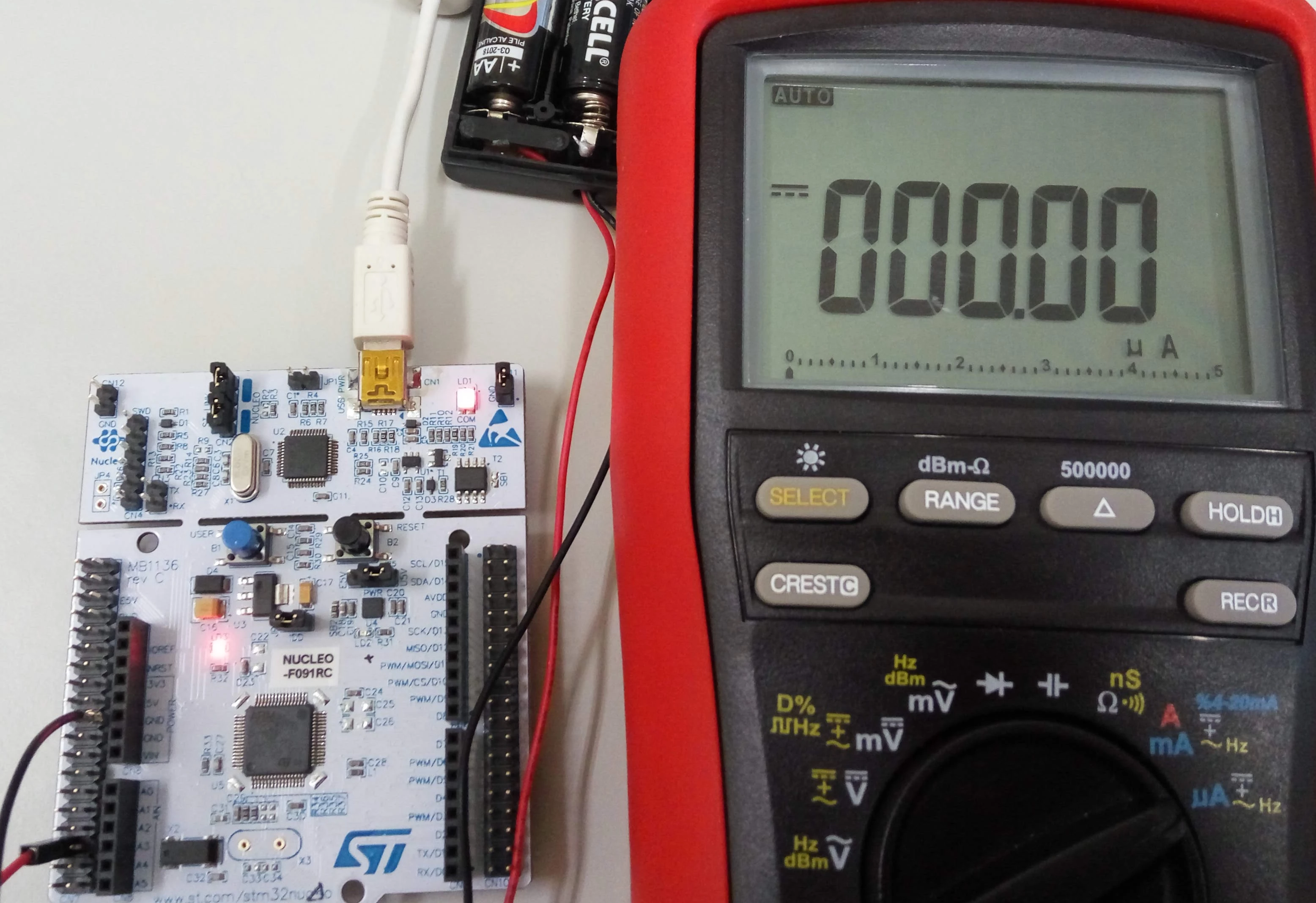

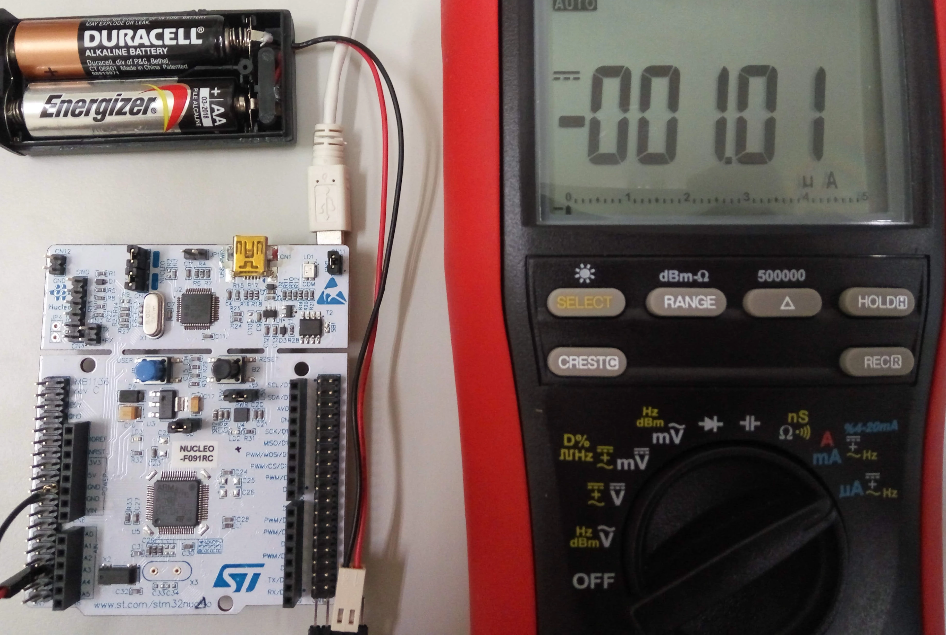

Zt Liu
Senior III
Jun 14, 2017 2:25 AM UTC
Posted on June 14, 2017 at 04:25
Using two AA batteries Vbat around 2.6V.
with VCC On.
VBat to Gnd impedance, there are few Mega Ohms.
As for your horrible mA current consumption....
Suppose you mcu is healthy and your board is correctly lay out.
Is it possible that your current measuring tool is problematic?
Can you test it with a reference current, like a current source?
