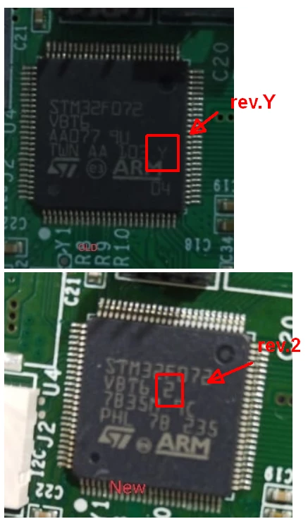

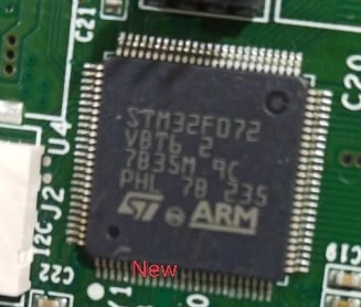

STM32F072VBT6 VS STM32F072VbT6 2
We have facing issue on microntroller we have recieve we have serial product and curretly we are using STM32F072VBT6 controller but we have order new lot and we are recieve STM32F072VBT6 2 and both are behaviour diffrent so what is major diffrence between them ? please suggest me.

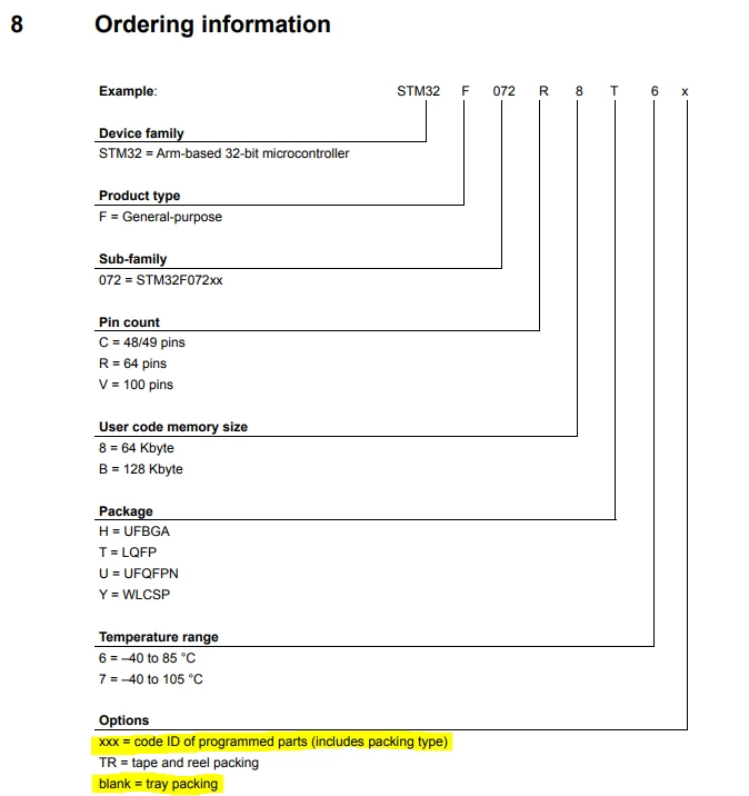

Hello @YShah.1​ ,
As already mentioned in the datasheet DS9826 and precisely section 8. ordering information, this marking indicates the options as shown in the below figure.
_legacyfs_online_stmicro_images_0693W00000biEKpQAM.pngWhen your question is answered, please close this topic by choosing Select as Best. This will help other users find that answer faster.

waclawek.jan
April 17, 2023
This is the chip revision
Check errata to find out if there's any relevant difference between the revisions - most likely, there is none.
> we are facing problem on one GPIO
What problem? On which GPIO? Do you have *all* supply pins (VDDxx, VSSxx) connected properly?

April 20, 2023
Sorry for long delay on this topic. There is indeed no mention of Rev 2 in errata sheet. This must be corrected rapidly.
However, Rev Y and Rev 2 are controllers produced with exactly identical masks, but on 2 different production plants. (As it is the case with Rev Y and Rev 1 already).
I suppose the different behavior you have observed on your 2 samples might more be linked to Option bytes settings or something similar than to the Silicon itself.
Hope it could help.
