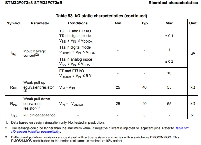

I want to know the Bus capacitance and Rise time of STM32F072V8T6 for I2C Calculation, Anyone who has know kindly tell me. Thank you.
6 replies
Andrew Neil
January 31, 2024

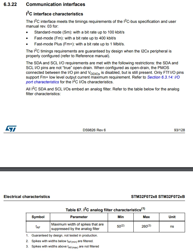

The capacitance of the bus, as the name suggests,  is defined by the whole bus - not just the microcontroller!
IO pin capacitance will be in the chip's Datasheet - under electrical characteristics:
The following pages give further AC characteristics
See also:

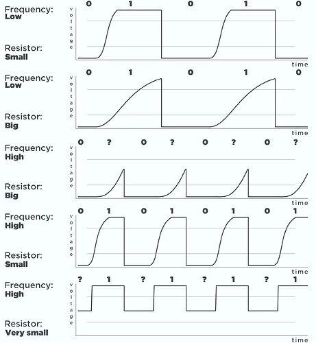

Again, that is defined by the external bus - not the microcontroller.
Specifically, it is defined by your pull-up resistors.
See this post:
https://electronics.stackexchange.com/questions/1849/is-there-a-correct-resistance-value-for-i2c-pull-up-resistors/473799#473799
It contains this diagram - which shows you the effect of the pullup value:
