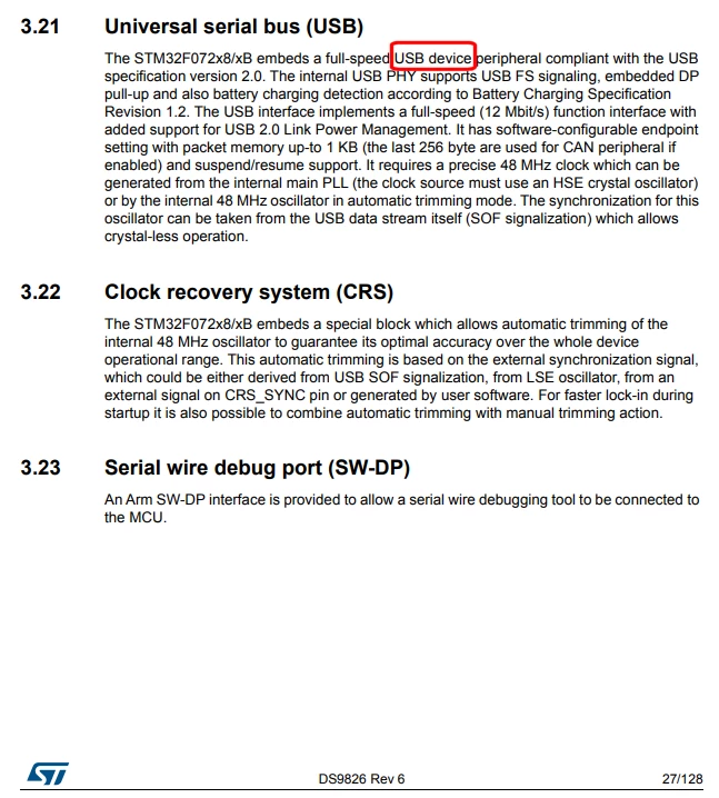

I'm using stm32f072rbt6 mcu for my project.
And I want to write data to my usb flash drive as a txt file.
I have researched some tutorials but to do this usually used mcu's such as stm32f767zit6 and these mcu's have USB_OTG_FS feature which my mcu doesn't have.
Is there any example or tutorial to do this with my stm32f072rbt6 mcu? or can I do that with my mcu?
Thank you!

@Batuhanoguz wrote:
I want to write data to my usb flash drive !
You wound need a USB Host for that - the stm32f072rbt6 has only a USB Device:
No.

@Batuhanoguz wrote:
I thought it's possible with any mcu.
No, it isn't - only MCUs which embed a Host (or OTG).
So you'll either have to change MCU, or add external Host hardware.
(some people have managed to bit-bang USB - but that's a non-trivial exercise)
