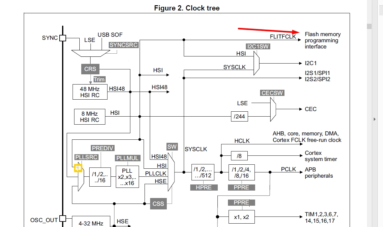

I'm french so i'm trying to be the more clear as possible ,
i use the stdperiph given by ST,
i got a timer with a blinking led , whatever i do with the PLL multiplier i got the same result on the led
and how do you change the flash latency?

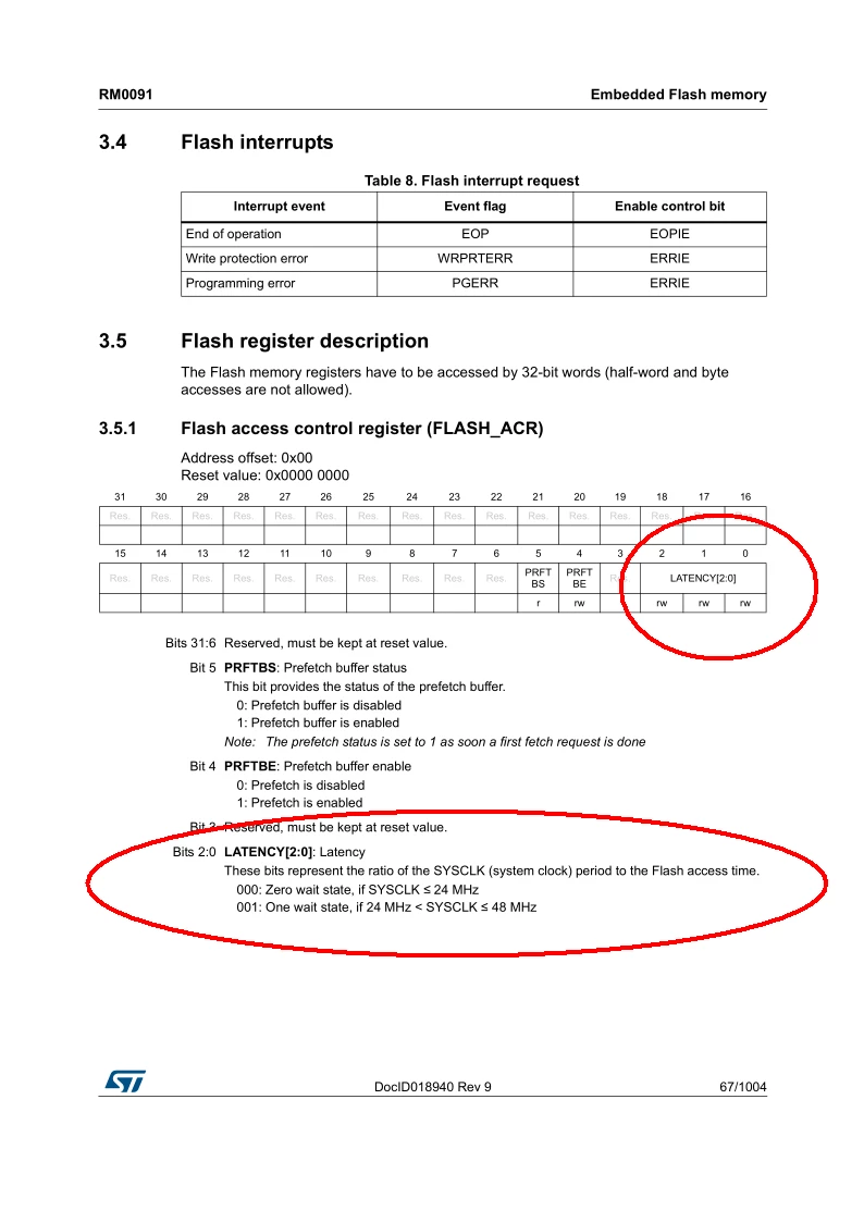

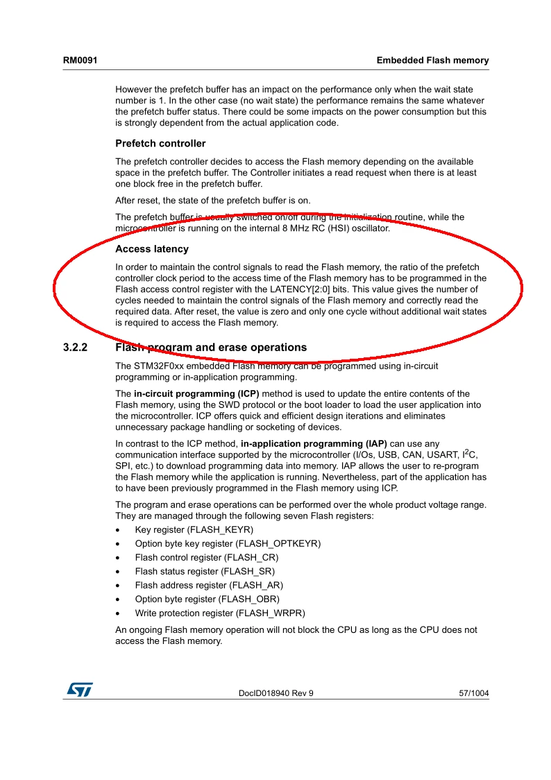

waclawek.jan
waclawek.janBest answer
April 20, 2022
It may be the "library" automatically changing the values set in Timer's registers, as you change the system clock. Read out and check the RCC and the Timer registers' content for the different versions.
0693W00000LyR7cQAF.png0693W00000LyR9JQAV.pngJW

I finaly succeed to set a 48Mhz clock but now the code seem work only in debug is latency can cause that problème?
i'm trying to change the latency to see if it work
