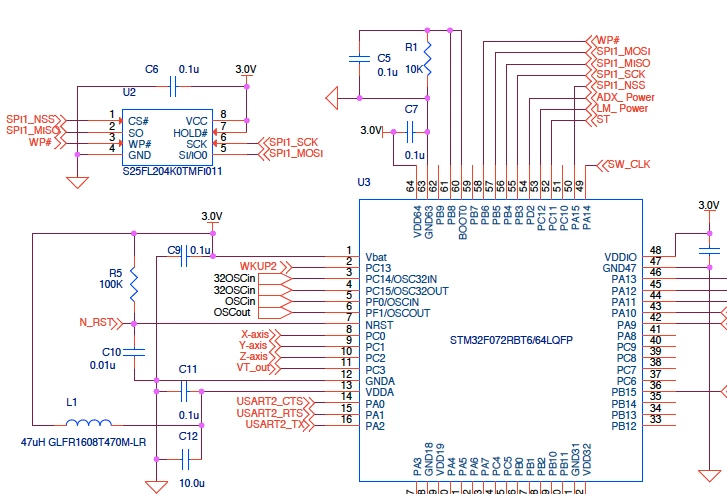

Hi All
I have the attached circuit and I need to read the battery level using ADC_IN18. I have the following instructions:
Init:

I'm getting the value 2072 +/- 4
This value I'm getting whether the battery is charged or empty.
Can someone help understand and solve it ? I'm not fw programmer, this just fall over me because our guy is sick and I need to deliver this project.

As both VBAT and VDDA are connected you are basically measuring a voltage against itself. ie VDDA (VREF) is full scale
You'd need to measure VREFINT the internal reference voltage, and use that to scale your measurement into a voltage. It should nominally be 1.2V, but there is calibration data, review
http://www.st.com/content/ccc/resource/technical/document/datasheet/cd/46/43/83/22/d3/40/c8/DM00090510.pdf/files/DM00090510.pdf/jcr:content/translations/en.DM00090510.pdf
If you get X for the internal reference, then VDDA = (4096 / X) * 1.2

Thank you very much for your reply.
So if I understood, I need the value of:
VREFINT_CAL (0x1FFF F7BA - 0x1FFF F7BB)
to get calibrated value and then:
val_vrefint = Adc_GetAdcValue ( ADC_Channel_17 );
VDDA = (4096 /
val_vrefint
) * VREFINT_CAL
Right ?
