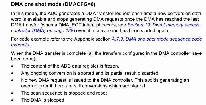

Thank you for the explanation. It was very helpful. I had an additional query. I am currently reading 6 analog channels using the DMA one shot mode. The DISCEN=0  and CONT= 0(I am sampling multiple channels in single conversion mode) .The data sheet says that, after the scan sequence the DMA is stopped. Does that mean that the DMAEN bit of the ADC_CFGR1 register becomes 0 or the EN bit of the DMA_CCR1 goes 0? However, I don't find any one of them go 0 in the watch window.
