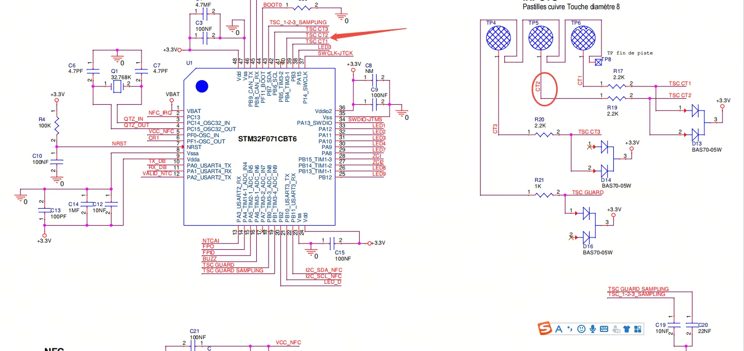

What could be the possible reason for the unresponsive feedback button on the production line? The defect rate is about 2% (total of 2000PCS).
The circuit diagram is as follows.
We conducted a plug-in replacement experiment, and the phenomenon followed the STM32F071CBT6TR.
We plan to conduct IV curve experiments on pins 39, 40, and 41 to determine if there are any issues with these pins. Additionally, we suspect that there may be a problem with pin 6. Have you encountered similar phenomena before? Where is the problem usually?

 Is there any way to write software for this chip to output a normal signal from the 39, 40, and 41 IO ports
Of course - that’s what the standard “Blinky” (flash an LED) example does!
Just adapt it to toggle the required pins …

Our preliminary judgment is that it may be an IO issue. Is there any way to write software for this chip to output a normal signal from the 39, 40, and 41 IO ports, in order to determine if there is a problem with the IO ports? If possible, please send the. bin file to this email address: jiangzz@unibetter-ic.com.
