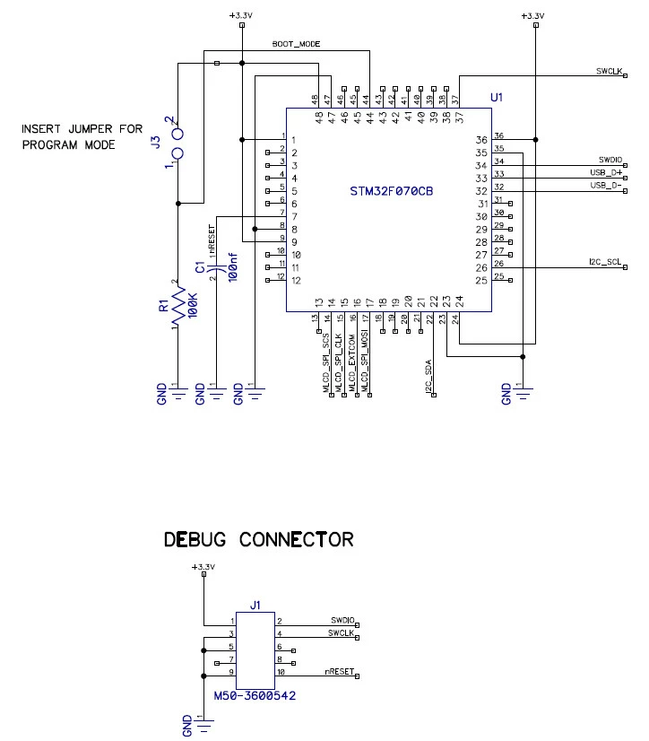

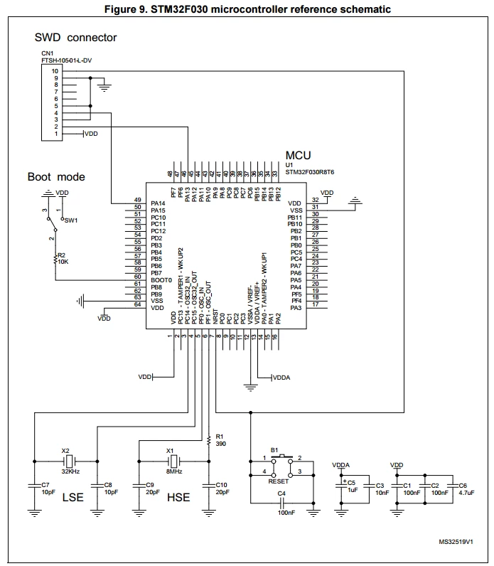

I am connecting a standalone board with a STM32f070 to a ST Link v2, but regardless all my efforts ST Link is unable to detect the MCU and I can not program it, I can not found any information about this issue, it seems everyone has done it straight forward with no issues. I am attaching some pics in how I am trying to connect the device to ST Link, I followed the schematics from ST official site with no results.
I have connected VCC 3.3 to board, I am sure GND is ok and jumper for programming is set.
