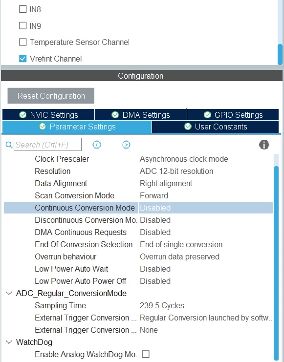

STM32F070 ADC single channel issue
0693W00000BbDjWQAV.pngHi,
Recently I started working on stm32F07 microcontroller. I am trying to read sensor value using ADC.
Issue: ADC value is keep on changing randomly(means its not holding value).
Below is my code. Please refer it and help me to figure out the issue.

ADC Configuration:
static void MX_ADC_Init(void)
 /* USER CODE BEGIN ADC_Init 0 */
 /* USER CODE END ADC_Init 0 */
 ADC_ChannelConfTypeDef sConfig = {0};
 /* USER CODE BEGIN ADC_Init 1 */
 /* USER CODE END ADC_Init 1 */
 /** Configure the global features of the ADC (Clock, Resolution, Data Alignment and number of conversion)
 hadc.Instance = ADC1;
 hadc.Init.ClockPrescaler = ADC_CLOCK_ASYNC_DIV1;
 hadc.Init.Resolution = ADC_RESOLUTION_12B;
 hadc.Init.DataAlign = ADC_DATAALIGN_RIGHT;
 hadc.Init.ScanConvMode = ADC_SCAN_DIRECTION_FORWARD;
 hadc.Init.EOCSelection = ADC_EOC_SINGLE_CONV;
 hadc.Init.LowPowerAutoWait = DISABLE;
 hadc.Init.LowPowerAutoPowerOff = DISABLE;
 hadc.Init.ContinuousConvMode = DISABLE;
 hadc.Init.DiscontinuousConvMode = DISABLE;
 hadc.Init.ExternalTrigConv = ADC_SOFTWARE_START;
 hadc.Init.ExternalTrigConvEdge = ADC_EXTERNALTRIGCONVEDGE_NONE;
 hadc.Init.DMAContinuousRequests = DISABLE;
 hadc.Init.Overrun = ADC_OVR_DATA_PRESERVED;
 if (HAL_ADC_Init(&hadc) != HAL_OK)
  Error_Handler();
 /** Configure for the selected ADC regular channel to be converted.
 sConfig.Channel = ADC_CHANNEL_0;
 sConfig.Rank = ADC_RANK_CHANNEL_NUMBER;
 sConfig.SamplingTime = ADC_SAMPLETIME_239CYCLES_5;
 if (HAL_ADC_ConfigChannel(&hadc, &sConfig) != HAL_OK)
  Error_Handler();
 sConfig.Channel = ADC_CHANNEL_VREFINT;
  Error_Handler();
 /* USER CODE BEGIN ADC_Init 2 */
 /* USER CODE END ADC_Init 2 */
IOC File:

ChahinezC
June 17, 2021
Hello @VDutt.1​,
First, please add the ADC calibration function to improve the conversion accuracy: HAL_ADCEx_Calibration_Start.
Another point is that I recommend you verifying the formula you are using to calculate the converted value.
Referring to the RM0360; the “Converting a supply-relative ADC measurement to an absolute voltage value�? part of the 12.9 section, if you have a known VDDA use the first formula, if not, refer to the VREFINT.
Chahinez.
