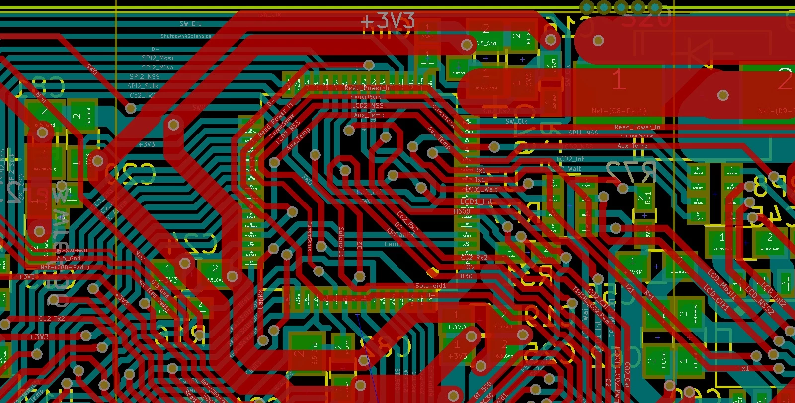

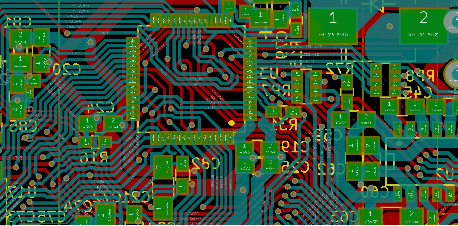

    here you can see the wide power tracks, I'd like you to check several aspects here.
    Can you see the mouse cursor in my pic ?
    it is sitting on a capacitor pair, I used 1uF and 0.1uF here on the power supply
    then the small tracks go from the Caps to the processor.
    Can you see along the power tracks they are other Capacitor pairs ?
