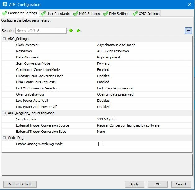

    And this is my ADC settings in the CubeMX

    this is not quite the same ...
    your code is tiny,
    I cant understand why my code is 2000 +lines for a short project,
    yours is under 20...

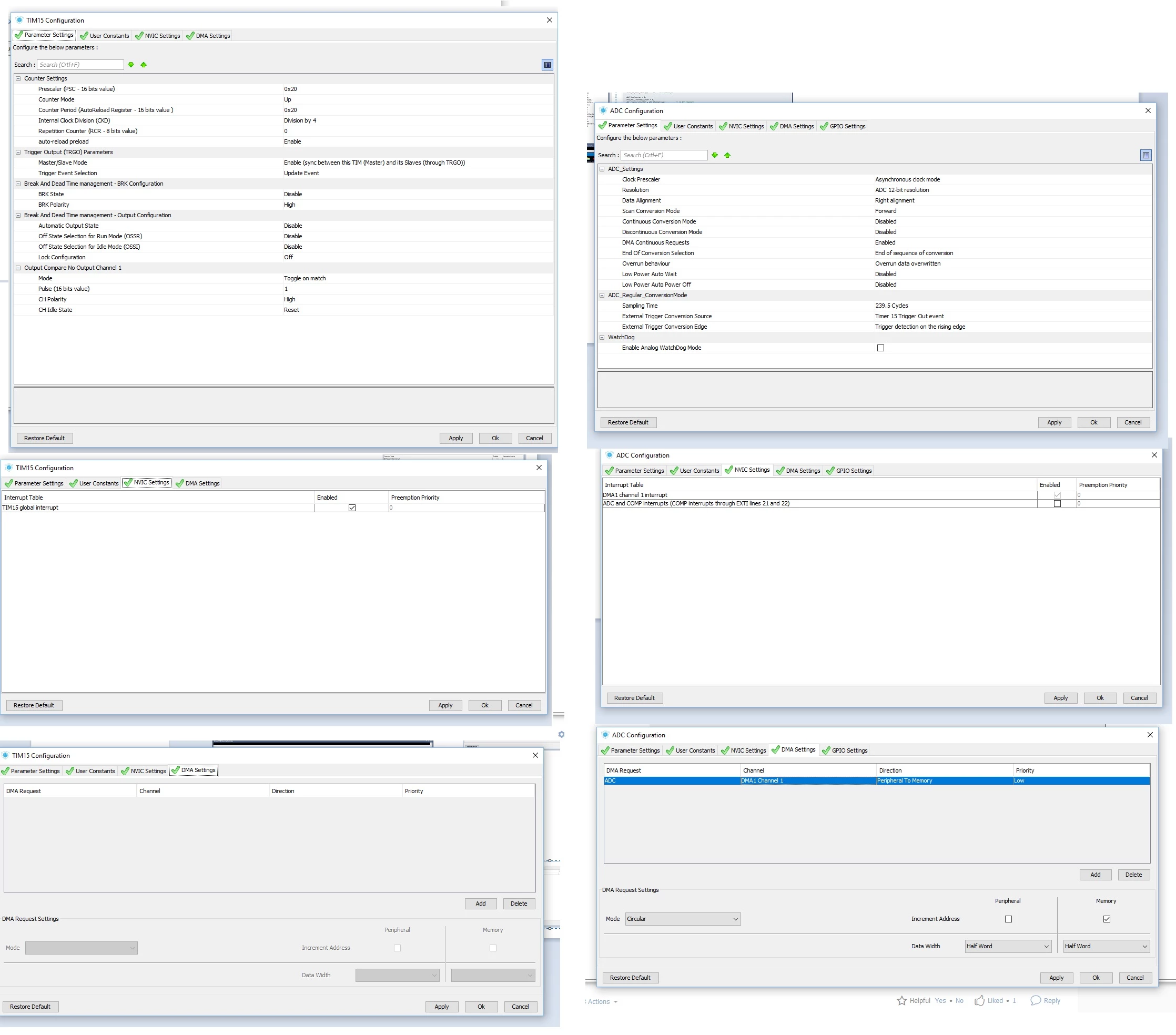

    August 11, 2018
    here is one of my boards setup
